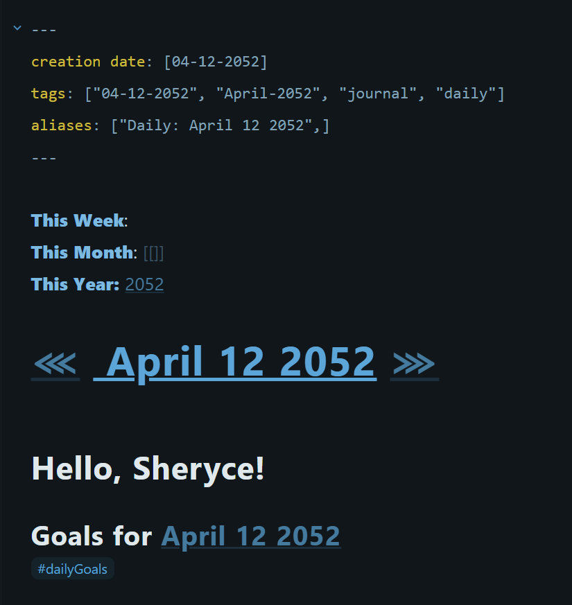

I use this format for my links
# [[3. Daily/<% tp.date.now("YYYY/MM/DD-MM-YYYY-dddd", -1) %>|⋘]] [[<% tp.date.now("YYYY/MM/DD-MM-YYYY-dddd") %> |<% tp.date.now("MMMM DD YYYY") %>]] [[3. Daily/<% tp.date.now("YYYY/MM/DD-MM-YYYY-dddd", +1) %>|⋙]]
It will appear like this,
If you’d like to keep your original, all you need to do is change it to this,
<<<[[3. Daily/<% tp.date.now("YYYY/MM/DD-MM-YYYY-dddd", -1 %>]] | [[3. Daily/<% tp.date.now("YYYY/MM/DD-MM-YYYY-dddd", +1 %>]]

The ⋘ and ⋙ symbols are singular unicode symbols. Though the design has three ticks, its only one symbol and it cannot direct you to multiple places
If you want the link to include the day after tomorrow, here’s an alternative format
[[3. Daily/<% tp.date.now("YYYY/MM/DD-MM-YYYY-dddd", -3) %>|<]][[3. Daily/<% tp.date.now("YYYY/MM/DD-MM-YYYY-dddd", -2) %>|<]][[3. Daily/<% tp.date.now("YYYY/MM/DD-MM-YYYY-dddd", -1) %>|<]] [[<% tp.date.now("YYYY/MM/DD-MM-YYYY-dddd") %>|<% tp.date.now("MMMM DD YYYY") %>]] [[3. Daily/<% tp.date.now("YYYY/MM/DD-MM-YYYY-dddd", +1) %>|>]][[3. Daily/<% tp.date.now("YYYY/MM/DD-MM-YYYY-dddd", +2) %>|>]][[3. Daily/<% tp.date.now("YYYY/MM/DD-MM-YYYY-dddd", +3) %>|>]]
or if the original is too weird or confusing you can replace the symbol with <> like so,
