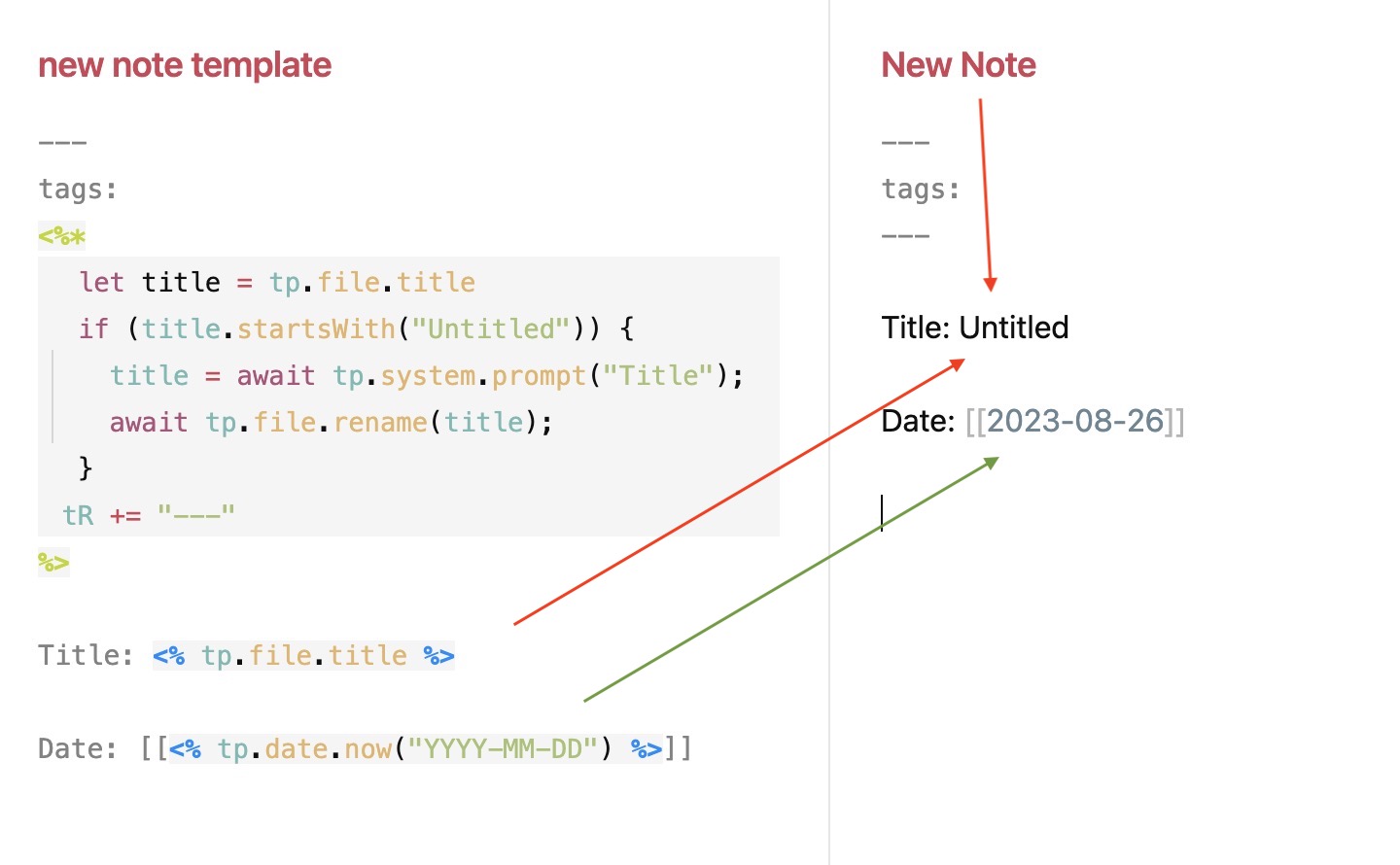

This is an example of a Templater template.
tags:
  let title = tp.file.title
  if (title.startsWith("Untitled")) {
    title = await tp.system.prompt("Title");
    await tp.file.rename(title);
 tR += "---"
Title: <% tp.file.title %>
Date: [[<% tp.date.now("YYYY-MM-DD") %>]]

When I use the sample template above:
  1. I am prompted for the file title twice
  2. Templater inserts the right date in the file
  3. Templater does not insert either of the titles from the prompts in point (1) above; it just names the file Untitled
Have uninstalled Templater and tried the same code in a test vault. Can’t get it to work.
