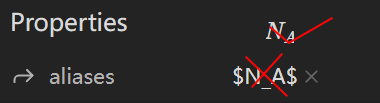

Bumping because this is still an issue and it affects me.
The workarounds provided in this topic don’t work in edit mode, just in reading mode.
This is a very commonly used feature, and I can’t live without it. T_T
