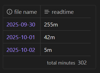

I have property in my yyyy-mm-dd daily notes that tracks how long I read each day, with the duration stored in minutes, such as readtime: 188m
Using Obsidian 1.10.0, is there a way to create a formula in a base that can sum all the minutes from the filtered daily notes?
Would be ideal to sum the minutes and then produce a total in days, hours, and minutes. Obsidian won’t sum the readtime property because of the m stored in the values. :thinking:

Given that readtime is a text (not a list) property, secondary-click your readtime column header then select Summarize... > Add summary and enter this formula:
values.filter(duration(value)).reduce(number(value) + acc, 0)
That should give you the total minutes.
You can decide what to do with it from there, such as append “m” or “minutes”, wrap the whole formula in duration() to use Bases’ built-in rounding, or parse it into days-hours-minutes format.

Of course, values.filter(duration(value)).reduce(number(value) + acc, 0) works perfectly. I scoured the help pages for bases for reduce but couldn’t find any mention of it. So I am pretty bamboozled by the bardic cipher, and I don’t even know what acc is or what it is doing. You presumably can apply coding knowledge to bases that I can only dream of. So I am very grateful for your help, but also in the dark about the what and why of it all.

FWIW, this also gives the same total when summing minutes:
values.filter(value).reduce(number(value) + acc, 0)
Don’t know why it works, nor if there are any pros or cons for this code, but leaving it here as a reference point.

This ought to work for duration():
duration(values.filter(duration(value)).reduce(number(value) + acc, 0) + "m")

I doubt I would have happened upon adding + "m" to the line unless I had had a boundless amount of time, working as I do à la the infinite monkey theorem. I don’t know what it is doing and why it works, but now the yearly totals read beautifully as days, for example, 25 days. Think I might stick with the original count of minutes for the time being until I can IMT a way to get something more expressive, along the lines of 3 weeks, 3 days, 8 hours, 28 minutes. Nice to have, but not critical in any way.
