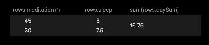

TABLE WITHOUT ID rows.meditation, rows.sleep, sum(rows.daySum)
FLATTEN sleep + meditation/60 as daySum
WHERE (file.name = "2023-05-30" OR file.name = "2023-05-31")
GROUP BY true
And produce the output of:
And here we see your wanted value in the last column. Notice also how it says (1) at the first column indicating that this table has only one row. This shows that the dual values for meditation and sleep are actually lists within the “first” (and only) row of this table.
