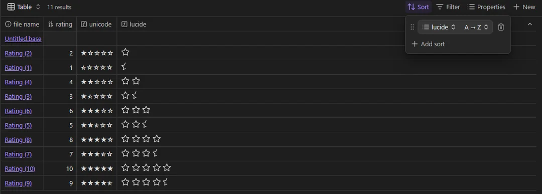

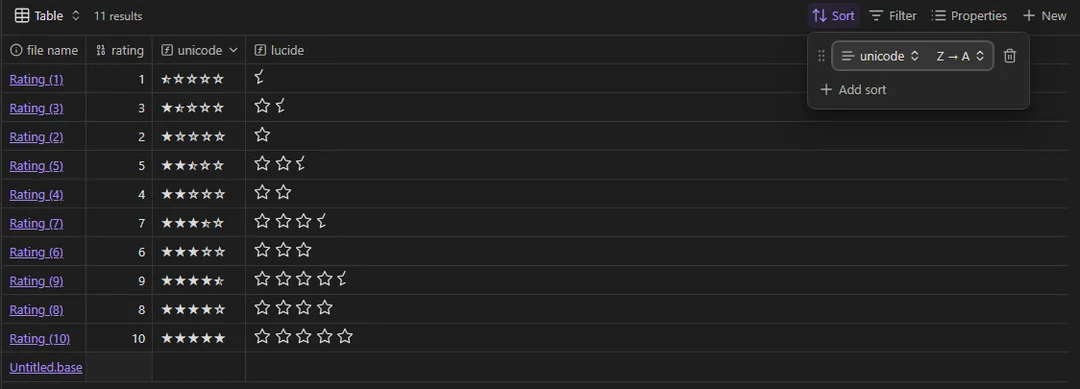

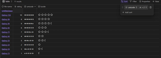

Ill add screenshots showcasing the problem and differences:

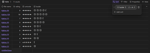

Lucide sorts:

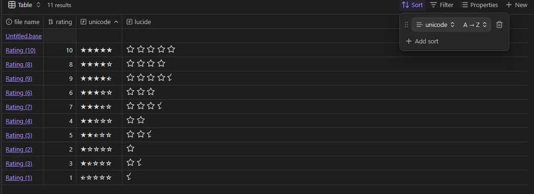

Unicode sorts
