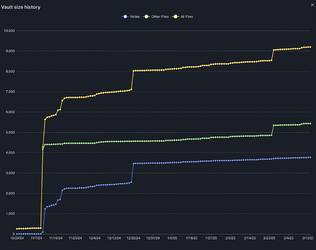

My question is: how do i use data view plugin to pull all files in my entire vault that were added between two dates? So say, between Feb 23, 2025 and Feb 26,2025?
(If data view is not the right tool for this job please let me know)
I have YAML frontmatter property for “created” that might be useful for this? But i do not think there is any way i created and imported 500+ attachments back in late February, so maybe this won’t help at all?
reason i am asking is to try to explain these last two massive spikes in “vault size” i have had recently:
```dataview
TABLE file.ctime AS created
WHERE file.ctime > date("2025-02-23") AND file.ctime < date("2025-02-26")
give this a shot!
I would add a sort line before the final three ticks
and you can add a limit
SORT file.ctime desc
Limit 100
ctime works much the same as cday for this.
