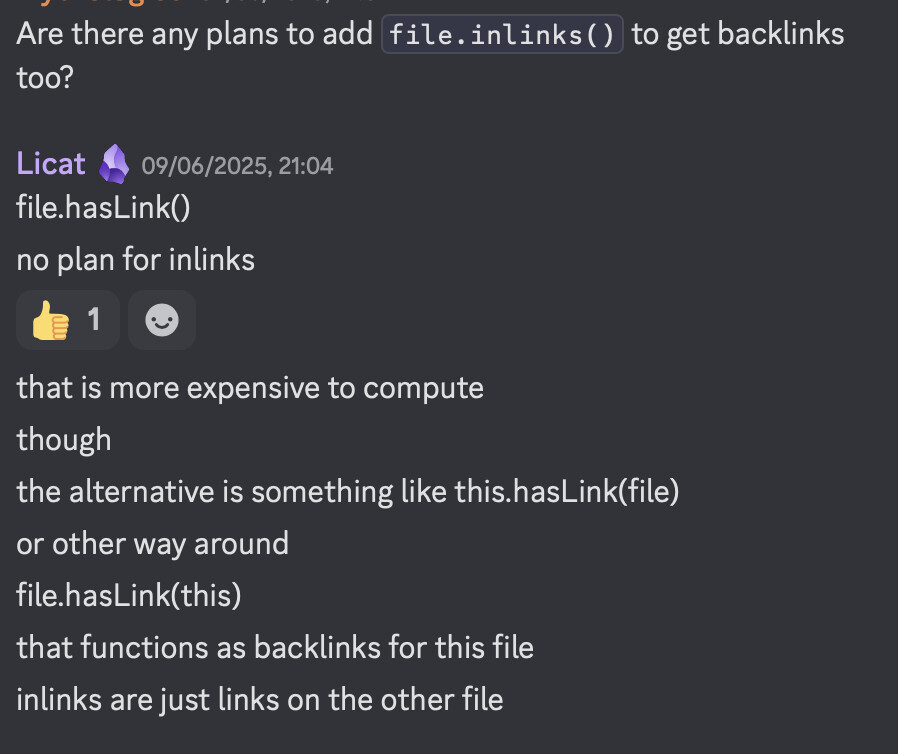

Thanks, James. I understand how to do this in Dataview. What I’m looking for (if it exists) is a way to accomplish the same thing in the new Bases core plug-in (currently in beta).
Hello.
Does the following help?
From: Discord
It helps from the standpoint of knowing that what I’m trying to do isn’t possible and not planned to be added. What I was hoping to do (which I could with file.inlinks() in Dataview) was get a table showing all the files have a specified inlink, and then another column that for each of those files shows all of the inlinks that they have. The file.hasLink(this) function can provide me with the inlinks for “this” file, but not for multiple files in the same table.
