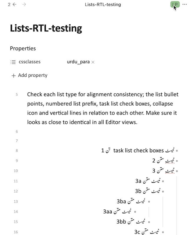

I am using Urdu/Arabic characters along with English words in one note. I’ve defined a separate class for it, which is setting the Urdu font correctly, but it also applies to English words. But I want fonts for English words, like Calibri font. Here is my css and using it with property cssclasses: urdu_para
.urdu_para {
    --file-line-width: 1000px;
    font-family: 'Jameel Noori Nastaleeq';
    direction: rtl;
    font-size:20px;
    word-spacing: 3px;
    margin-top: 2px;
    margin-bottom: 20px;
    margin-right: 20px;
    margin-left: 20px;
And here is the preview.

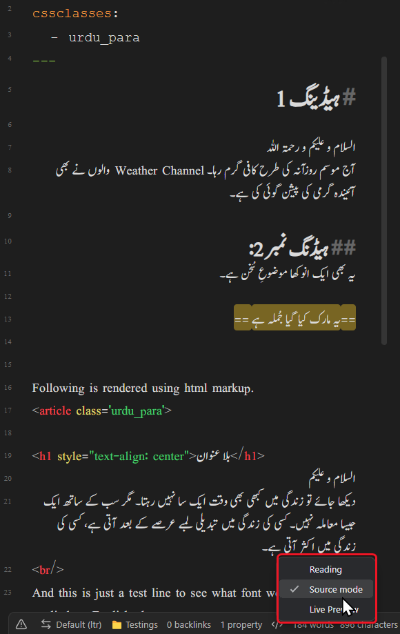

Note: the CSS as written isn’t changing the fonts in the editor; it’s only affecting Reading view.

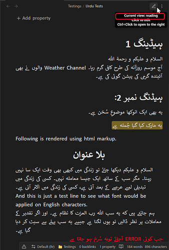

I had already tried font-family: 'Calibri', 'Jameel Noori Nastaleeq';. This would simply set the Calibri font on top. As far I have observed, the first font in font-family takes the priority. If fist font is not available, then the next font come into use.
Here is the preview after using font-family: 'Calibri', 'Jameel Noori Nastaleeq';:
Reading and Live Preview Modes.

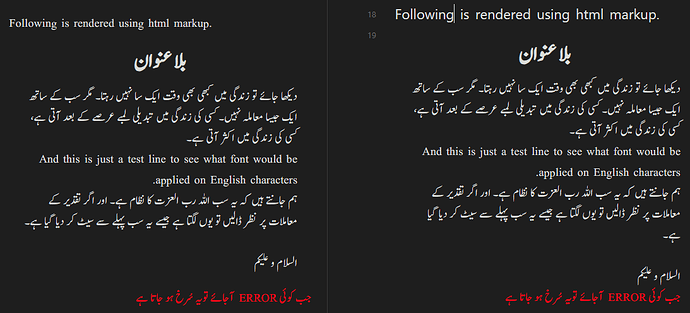

I know, I can use HTML like <span> or <article> etc and it would work in Live Preview Mode: Here is an example of such para using
<article class='urdu_para'>
See the English lines which are taking Jameel Noori Nastaleeq as well. If I use font-family: 'Calibri', 'Jameel Noori Nastaleeq';, the whole would start using Calibri and Jameel Noori Nastaleeq would only be used if Calibri is not available.
The problem in using HTML like that, you can’t use Markedown in HTML area. For instance, to make a heading you can’t use # or ### or to mark your lines, you can’t use ==Marked Lines==. You must use HTML tags here like h1, h2 or <mark>Marked Lines </mark> which is bit difficult to type as compared to MD tags.
It is. The CSS just needs to be written differently.
/* editor font */
.markdown-source-view.mod-cm6.urdu_para .cm-scroller {
    font-family: 'MonaSpace Argon', 'Jameel-Noori-Nastaleeq'; }
/* reading view font */
.markdown-preview-view.urdu_para {
CleanShot 2024-06-16 at 19.59.31

And here is the result from Reading Mode:
i.e. Calibri has taken over.
