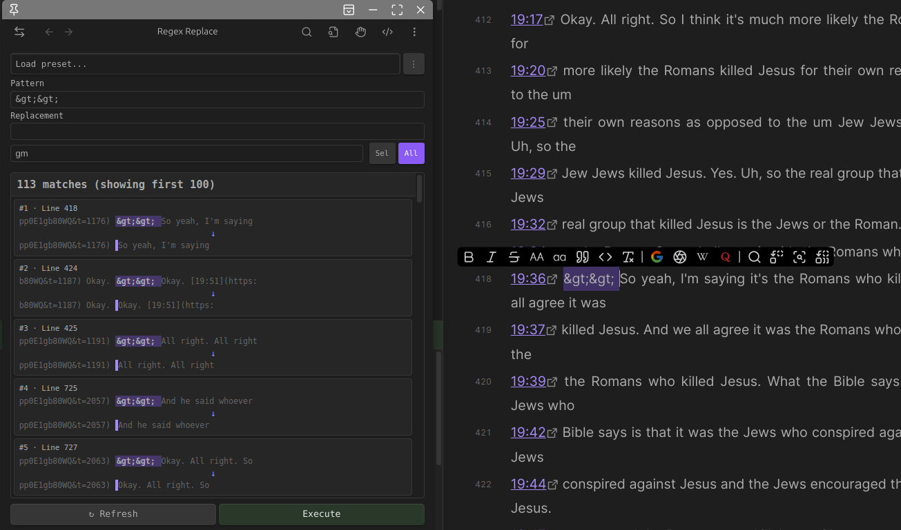

This is quite handy:
The plugin lives in your sidebar, can save and load patterns and can replace on the whole file or selection only.
No need for commands as you pick your replacement rule.
I think I updated the post with the latest bug fix. But I think I may have since added to the plugin.
Save as ‘main.js’:

					new Notice(`Match ${i + 1}/${matches.length}`);
			// Match number and location
			matchBox.createEl("div", {
				text: `#${i + 1} · Line ${lineNumber + 1}`,
				attr: { style: "font-size: 0.7em; color: var(--text-muted); margin-bottom: 4px;" }
			// Before
			const beforeDiv = matchBox.createEl("div", { attr: { style: "font-family: var(--font-monospace); font-size: 0.75em; margin-bottom: 2px; word-break: break-all;" }});
			beforeDiv.innerHTML = '<span style="color: var(--text-faint);">' + this.escapeHtml(beforeContext) + '</span><span style="background: var(--text-selection); font-weight: bold; padding: 1px 2px;">' + this.escapeHtml(match) + '</span><span style="color: var(--text-faint);">' + this.escapeHtml(afterContext) + '</span>';
			// Arrow
				text: "↓",
				attr: { style: "text-align: center; color: var(--text-accent); font-size: 0.8em; margin: 2px 0;" }
			// After
			const afterDiv = matchBox.createEl("div", { attr: { style: "font-family: var(--font-monospace); font-size: 0.75em; word-break: break-all;" }});
			afterDiv.innerHTML = '<span style="color: var(--text-faint);">' + this.escapeHtml(beforeContext) + '</span><span style="background: var(--text-accent); color: var(--text-on-accent); font-weight: bold; padding: 1px 2px;">' + this.escapeHtml(replacement) + '</span><span style="color: var(--text-faint);">' + this.escapeHtml(afterContext) + '</span>';
		if (hasMore) {
			previewEl.createEl("div", {
				text: `... and ${matches.length - displayCount} more matches`,
				attr: { style: "padding: 12px; text-align: center; color: var(--text-muted); font-style: italic; background: var(--background-secondary); margin: 4px; border-radius: 4px;" }

	async onOpen() {
		const container = this.containerEl.children[1];
		container.empty();
		container.addClass("regex-replace-sidebar");

		const controlsDiv = container.createDiv("regex-compact-controls");
		// Preset management
		const presetHeader = controlsDiv.createDiv("regex-preset-header");
		const presetDropdown = presetHeader.createEl("select", { cls: "regex-preset-dropdown" });
		presetDropdown.createEl("option", { text: "Load preset...", value: "" });
		this.plugin.settings.presets.forEach(p => {
			presetDropdown.createEl("option", { text: p.name, value: p.name });
		presetDropdown.addEventListener("change", (e) => {
			const val = e.target.value;
			if (val) {
				const preset = this.plugin.settings.presets.find(p => p.name === val);
				if (preset) {
					this.loadPreset(preset);
					this.currentPresetName = val;
					this.plugin.settings.currentPresetName = val;
					this.plugin.saveData(this.plugin.settings);
					if (currentPresetDisplay) {
						currentPresetDisplay.textContent = val;
						currentPresetDisplay.style.display = "block";
						currentPresetDisplay.title = val;
					new Notice("Loaded: " + val);
				presetDropdown.value = "";
		// Add current preset display
		const currentPresetDisplay = controlsDiv.createEl("div", {
			text: this.currentPresetName || "",
			attr: {
				style: `display: ${this.currentPresetName ? 'block' : 'none'}; padding: 6px 8px; margin-bottom: 6px; background: var(--background-secondary); border-left: 3px solid var(--interactive-accent); border-radius: 3px; font-size: 0.8em; color: var(--text-muted); word-wrap: break-word; overflow-wrap: break-word; max-width: 100%;`
		if (this.currentPresetName) {
			currentPresetDisplay.title = this.currentPresetName;
		const menuBtn = presetHeader.createEl("button", { text: "⋮", cls: "regex-menu-btn" });
		menuBtn.addEventListener("click", (e) => {
			const menu = new Menu();
			menu.addItem((item) =>
				item.setTitle("Save current as preset").setIcon("save").onClick(() => {
					new PresetNameModal(this.app, (name) => {
						this.plugin.settings.presets = this.plugin.settings.presets.filter(p => p.name !== name);
						this.plugin.settings.presets.push({
							name,
							pattern: this.pattern,
							replacement: this.replacement,
							flags: this.flags,
							onlySelection: this.onlySelection,
							replaceAll: this.replaceAll
						// Refresh dropdown
						presetDropdown.innerHTML = "";
						new Notice("Preset saved: " + name);
					}).open();
			if (this.plugin.settings.presets.length > 0) {
				menu.addSeparator();
					item.setTitle("Delete preset...").setIcon("trash").onClick(() => {
						const deleteMenu = new Menu();
							deleteMenu.addItem((delItem) =>
								delItem.setTitle(p.name).onClick(async () => {
									this.plugin.settings.presets = this.plugin.settings.presets.filter(pr => pr.name !== p.name);
									await this.plugin.saveData(this.plugin.settings);
									this.plugin.settings.presets.forEach(pr => {
										presetDropdown.createEl("option", { text: pr.name, value: pr.name });
									new Notice("Deleted: " + p.name);
						deleteMenu.showAtMouseEvent(e);
				item.setTitle(this.autoPreview ? "Disable auto-preview" : "Enable auto-preview")
					.setIcon(this.autoPreview ? "eye-off" : "eye")
					.onClick(() => {
						this.autoPreview = !this.autoPreview;
						this.plugin.settings.autoPreview = this.autoPreview;
						new Notice(this.autoPreview ? "Auto-preview enabled" : "Auto-preview disabled - use Refresh button");
			menu.showAtMouseEvent(e);
		// Pattern input
		controlsDiv.createEl("span", { text: "Pattern", cls: "regex-label" });
		const patternInput = controlsDiv.createEl("input", { cls: "regex-input", value: this.pattern });
		patternInput.addEventListener("input", (e) => {
			this.pattern = e.target.value;
			this.updatePreview();
		this.controls.pattern = { setValue: (v) => patternInput.value = v };
		// Replacement input
		controlsDiv.createEl("span", { text: "Replacement", cls: "regex-label" });
		const replacementInput = controlsDiv.createEl("input", { cls: "regex-input", value: this.replacement });
		replacementInput.addEventListener("input", (e) => {
			this.replacement = e.target.value;
		this.controls.replacement = { setValue: (v) => replacementInput.value = v };
		// Flags and toggles row
		const flagsRow = controlsDiv.createDiv("regex-flags-row");
		const flagsInput = flagsRow.createEl("input", { cls: "regex-flags-input", value: this.flags, attr: { placeholder: "gim" } });
		flagsInput.addEventListener("input", (e) => {
			this.flags = e.target.value;
		this.controls.flags = { setValue: (v) => flagsInput.value = v };
		const toggleGroup = flagsRow.createDiv("regex-toggle-group");
		const selToggle = toggleGroup.createEl("button", { text: "Sel", cls: "regex-toggle-btn" });
		if (this.onlySelection) selToggle.addClass("active");
		selToggle.addEventListener("click", () => {
			this.onlySelection = !this.onlySelection;
			selToggle.toggleClass("active", this.onlySelection);
		this.controls.onlySelection = { setValue: (v) => { this.onlySelection = v; selToggle.toggleClass("active", v); }};
		const allToggle = toggleGroup.createEl("button", { text: "All", cls: "regex-toggle-btn" });
		if (this.replaceAll) allToggle.addClass("active");
		allToggle.addEventListener("click", () => {
			this.replaceAll = !this.replaceAll;
			allToggle.toggleClass("active", this.replaceAll);
		this.controls.replaceAll = { setValue: (v) => { this.replaceAll = v; allToggle.toggleClass("active", v); }};
		// Preview container
		const previewContainer = container.createDiv("regex-preview-container");
		const previewEl = previewContainer.createDiv("regex-preview-results");
		// Action bar
		const actionBar = container.createDiv("regex-action-bar");
		const refreshBtn = actionBar.createEl("button", { text: "↻ Refresh" });
		refreshBtn.addEventListener("click", () => {
			// Force immediate preview update
			if (this.previewTimeout) {
				clearTimeout(this.previewTimeout);
			this.showPreview(previewEl);
		const executeBtn = actionBar.createEl("button", { text: "Execute", cls: "mod-cta" });
		executeBtn.addEventListener("click", () => this.executeReplace());
		// Initial preview

My plugin (version of the original shared in the thread linked above) shows live preview of prospective changes with highlights. So you only shoot when ready.
Using it elevated out into Hover Editor window instance:
All UI parts are straighforward to use and save to data.json in plugin folder.

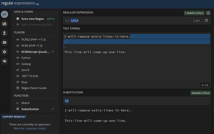

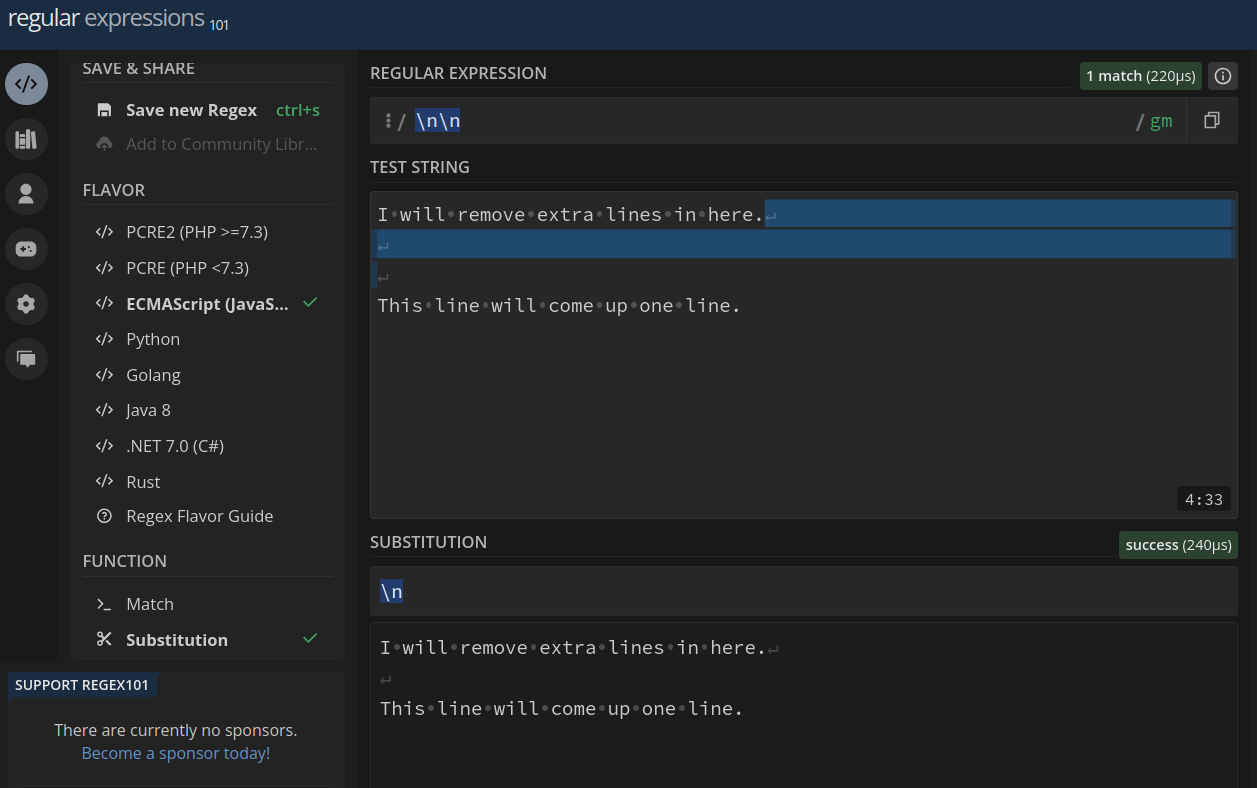

When constructing one, you can use AI help and the regex101.com site. Just set the UI to Subsitution below and choose the Js flavour. A simple case to check what you are doing is what you expect:
Try to add more lines to the Test String side with dealing with more elaborate regexes. Try to learn about problem points in regex (like how you can use ? to limit scope; it’s important to know how to defend against losing your data). AI can help but sometimes they act wobbly around regex if you don’t specify exactly what is your ‘Before’ state and ‘After’ requirement.
