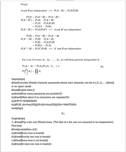

Part way through, the LaTeX code starts to be rendered as regular text and the regular text is rendered as if it is

It looks normal in reading view. That’s why I’m surprised the PDF doesn’t look the same.

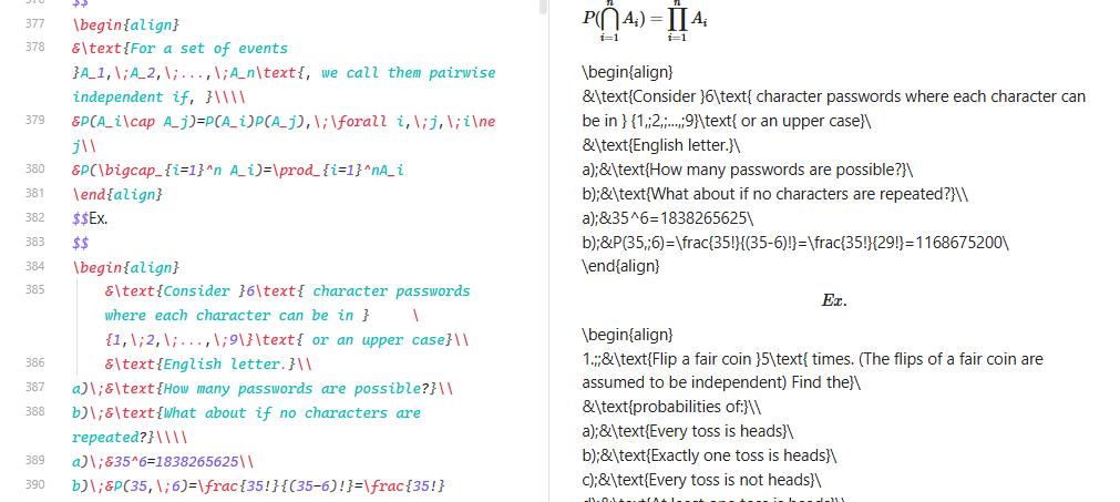

It’s broken in Reading view so will be in the PDF as well. The first break, where it starts to go wrong anyway, looks like line 382:
$$Ex.
That Ex. should be on its own line.
source mode | reading view
Oh, sorry I misunderstood. I’m not sure why it goes wrong there since I’ve made notes with back to back LaTeX environments before without this issue.
Ok, so after fixing that one line, the rest of Reading view and PDF export looks alright on my end.
