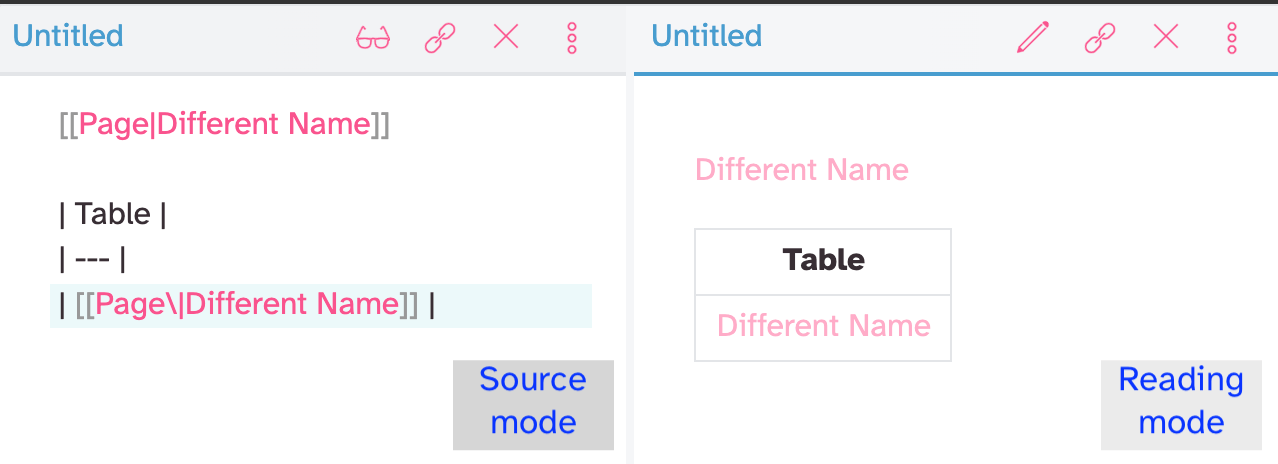

Does escaping the rename work for you?
[[Page|Different Name]]
| Table |
| [[Page\|Different Name]] |
Angel
Ah! That’s the workaround.
The pipe (|) in the link must be interacting with the pipes in the table
