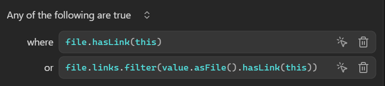

For the first one, and presuming you’re talking about the currently active note, use these two filters:
filters:
  or:
    - file.hasLink(this)
    - file.links.filter(value.asFile().hasLink(this))

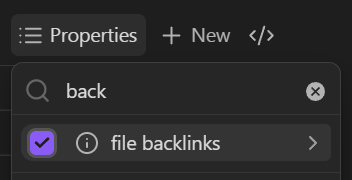

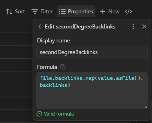

For the second one, click Properties and select file backlinks, and then click Add formula and add this formula:
file.backlinks.map(value.asFile().backlinks)
