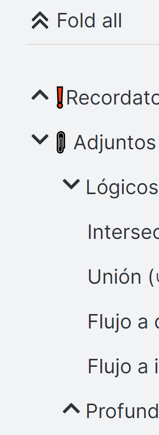

Thanks a lot for the plugin!. I’m working intensively with it. I have quick suggestions/ideas if you are interested on add it to the plugin, try to resolve it with Macro Script o share with me any previous/existing solution.
  1. Note name suggestions: It will be great to see name suggestions based in existing notes in name prompt (“Template” actions). Quick tip: You can add [[ and deleting it to do it. This will be use to add new registers in existing diseases and also add new ones based on templates.
    Example:
  2. Disable open the same file when is already open (“Template” actions): Continuing with the last example, when I create a new register to an existing diseases’ note (with “Open the created file” enable), Quickadd open it again. It will be great to have a way to stop open the file when is already active.
    Example:
  3. Native Multi-select suggester: Using {{VALUE:}}, change the " , " for a " + " to activate the “multi-variable”. It will show a Checkbox in the left side of the classic promp option. (PD: I think the creator already have it in their To Do)
    Example: {{VALUE:X+Y+Z}} Test
  4. Note-based suggester variables (Like “List from a range” of Google Sheets): Using {{VALUE:}} with [[Link]] it will be possible to add new variables quickly (also with other Quickadd’s actions).
    Example: {{VALUE:[[Note A]]}}
  5. Fold/Unfold all actions button: A quickway to do it, it will be awesome.
    Example:
Idk if this is simple to implement, but hopefully work as inspiration to you! Thanks again for this great plugin!
