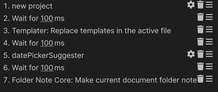

I use the Quickadd plugin to automate a new project creation.
This is my setup:
  1. is the general template
  2. is to activate a cursor placement, so 5. gets retuned there.
  3. is the templater script I want to run and this is the code. Just a simple suggester…

I have tried to reorganize the quickadd macro, trying to figure out how it works to understand why the script gets added twice. I have no clue why it does that, and I suspect that it is a bug. Everything else works fine.
To clarify, it gives me the suggester prompt twice. If I call the script on its own, it does not do that.
Does anyone know what I am doing wrong or is this just a bug?
