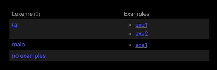

You do need to flip the query around, and focus on those lexeme entry, as you call them, and then rather list those actually having examples connected to them. However, in order to do so you’ll need to do a double loop on inlinks to the lexeme entry, and picking from the lexemy entry on the examples.
Test case 1: [[ra]] - linked from [[exe1]] & [[exe2]]
Test case 2: [[malo]] - linked from [[exe1]]
Test case 3: [[no examples]]  - not linked
```dataview
TABLE WITHOUT ID file.link as Lexeme, linkedExamples as Examples
WHERE file.folder = this.file.folder
  AND glos = "ja"
FLATTEN list(filter(file.inlinks, (inlink) => contains(inlink.lexeme, file.link))) as linkedExamples
Using a note with the query above, and assuming that all files are in the same folder and the dictionary entries are those having glos: ja, this listed the following:
The trick to this query is to first use filter on the file.inlinks as all links in a file if properly placed somewhere is listed in that list, and then to actually verify that link we want is within the lexeme list.
