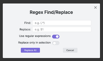

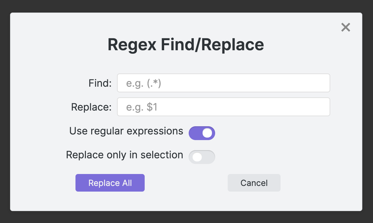

To remove the images
Use this plugin: Regex Find/Replace
With regular expressions, you can find patterns like gif;base64. I’m not too familiar with this format, but I assume it would be easy to identify the beginning and the end of any image. However you would need to do that manually for each note, that sounds annoying.

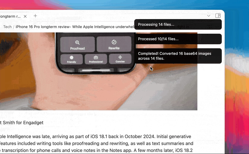

To convert the images (Base64 to PNG)
Use this plugin: Convert Base64 to PNG
I would probably use that one, see the features below:
  • Base64 Detection: Automatically detects base64-encoded images in your notes
  • Local Conversion: Converts base64 images to local PNG files
  • Batch Processing: Process individual files or all files in your vault
  • Customizable Storage: Configure where and how PNG files are stored
  • Automatic Conversion: Option to automatically convert base64 images when pasting
Thank you Grimoire!
Thanks to your instructions, I was able to find it and install it easily.
But figuring out how to access it was another story. So far I’m climbing a steep learning curve using Obsidian. But I finally got it installed to the editing toolbar.
I spent much more time trying to figure out how to make a good regex search. I used to be pretty good at it about 25 years ago. Either I’ve gotten rusty or it’s changed. Probably the former.
I finally came up with one that is doing exactly what I want. It’s pulling the links to worthless image files but it’s leaving any useful hyperlinks alone.
I’m going to list the search expression below here. I added spaces between each of the characters so that it has a chance of being readable or accepted by the forum. You’ll have to remove those before the expression will work.
Oh, and a shout out to Martin Eder. Nice tool that you made thank you!
BUT, I still had a problem. Even after stripping the image files out it still had multiple line returns and duplicated equations messing things up.
I tried to make a RegEx expression to fix those but finally gave up. I don’t think Martin’s plug in works on line breaks.
I found Elias Jaffe’s “Remove Newlines” plug-in( thanks Elias!).
I still have to find each problem section one at a time, remove one of the duplicate expressions and then highlight over the area and use Elias plug in. Then move on to the next one.
Not a one click solution but this combination sure makes it easier and faster to clean this mess up.
