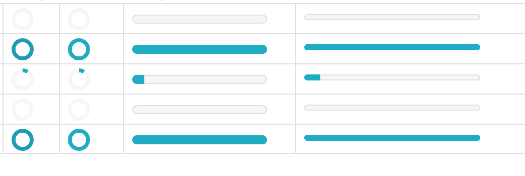

I want to add a warning, that after Obsidian 1.10.0 goes public I am planning to remove the support of progress bars in bases from the plugin. That is because you will be able to create them without the plugin, just with a formula.
If you are an insider and already on 1.10.0, I recommend you to switch already. Just change you base progress formulas to this:
if( note["maxProperty"], html("<progress max='" +
note["maxProperty"] + "' value='" +
if(note["valueProperty"], note["valueProperty"], 0) +
"' aria-label='" +
if(note["maxProperty"], (if(note["valueProperty"], note["valueProperty"], 0) / note["maxProperty"] * 100).round(), " ") + " %" +
"' data-tooltip-position='top' data-tooltip-delay='500'>"), "")
Replace “maxProperty” and “valueProperty” to your own properties. You can also remove “aria-label” and data-tooltip options it you don’t care about tooltip.
Here is also the formula for the circle progress:
if(note["maxProperty"], html("<div  style='background: radial-gradient(closest-side, var(--background-primary) 64%, transparent 65% 100%), conic-gradient(var(--color-accent-1) " + if(note["maxProperty"], (if(note["valueProperty"], note["valueProperty"], 0) / note["maxProperty"] * 100).round(), 0) + "%" + ", var(--background-secondary) 0); height: 22px; aspect-ratio: 1; border-radius: 50%' aria-label='" +
"' data-tooltip-position='top' data-tooltip-delay='500'></div>"), "")
I am also planning a big performance update, so keep tuned.
Good thing, we can add that formula easily in any data table.
Round progress are same. But the progress bar made according to the new formula is a bit thin. How can we increase its thickness?

I am not planning to remove task calculation, only progress bar rendering in bases.
To make progress bar thicker you need to use some css. You can add your own, or you can add “class=‘metadata-progress’” to the html element to use css from Pretty properties.
Like this:
if( note["maxProperty"], html("<progress class=‘metadata-progress’ max='" +
"' aria-label='" +

Thx for the css tip. :hugs:
