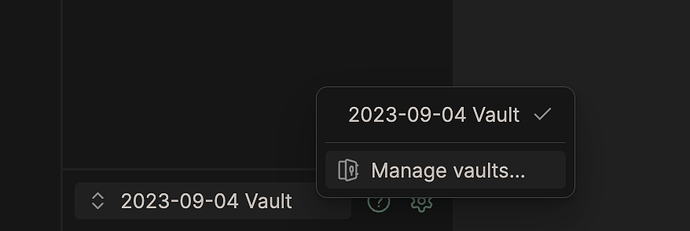

  1. open Obsidian application
  2. open the left side panel
  3. click on the Vault name (ETE Vault?) all the way at the bottom
  4. click manage Vaults…
  1. click “Open folder as Vault” and find your iCloud folder like you have in the steps above
  2. click Open and that should be it

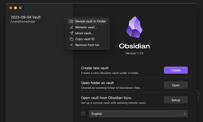

The next step would be to delete the unnecessary ETE Vault:
  1. go back into Manage Vaults option
  2. on the left side of that menu you should now have two Vaults, click on on the 3 dots next to ETE Vault (which you want to delete)
  3. click “Reveal Vault in File explorer” (or whatever they call it)
  1. delete that folder since its empty and you don’t need it.
  • If you’ve already made some new files in it, copy them into Tyner Vault before deleting everything
  • If it still shows up in the Vault list, repeat the steps and click Remove from list.
