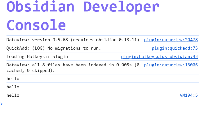

Then maybe try creating a new note and adding this line:
<%* console.log("hello") %>
Place the note in your Templater folder (make sure it’s set correctly in the Templater settings), then use the command palette to run Templater: Open insert template modal and select your template.
After that, check the console.
So this script runs, meaning the problem isn’t Templater but your scripts instead.
