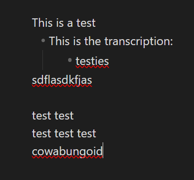

I record meetings and use a service to transcribe them. These transcriptions are very long, so I like to put them into a sub-bullet and collapse them.
When I paste, the first newline breaks out of the bullet and puts the rest of the text outside the bullet list.
I am migrating from logseq. Logseq allowed me to paste into a block that kept the entire pasted text within the block. I hope to find a way to paste into an obsidian bullet that does the same thing.
In Logseq, pasting would always keep things at the same depth. Double newlines would start a new bullet/block, but at the same depth as the first.

Example:
Copying this text:
testies
sdflasdkfjas
test test
test test test
cowabungoid
Pastes looking like this:
I don’t know if there’s a way to get the paste behavior you want, but you can fix the text by indenting all the lines after the first one twice to indicate that they are part of the sub list item. You can do the indenting before or after copy-pasting.
This is a test
- Transcription
	- test
		sdflasdkfjas
		test test
		test test test
		cowabungoid
In Obsidian you can do it by selecting the lines and pressing Tab twice (or using the Indent command twice; on mobile you can add this to the toolbar).

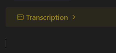

I think I found a good workflow using a custom callout. It behaves itself when it’s collapsed, it doesn’t expand without being clicked.
.callout[data-callout="transcription"] {
    --callout-color: 150, 129, 25;
    --callout-icon: lucide-captions;
I’m happy with this. Funny thing is it took me too long to get used to the logseq block design and now it’s hard to move away from it. I think as a whole I prefer the less opinionated obsidian approach.
