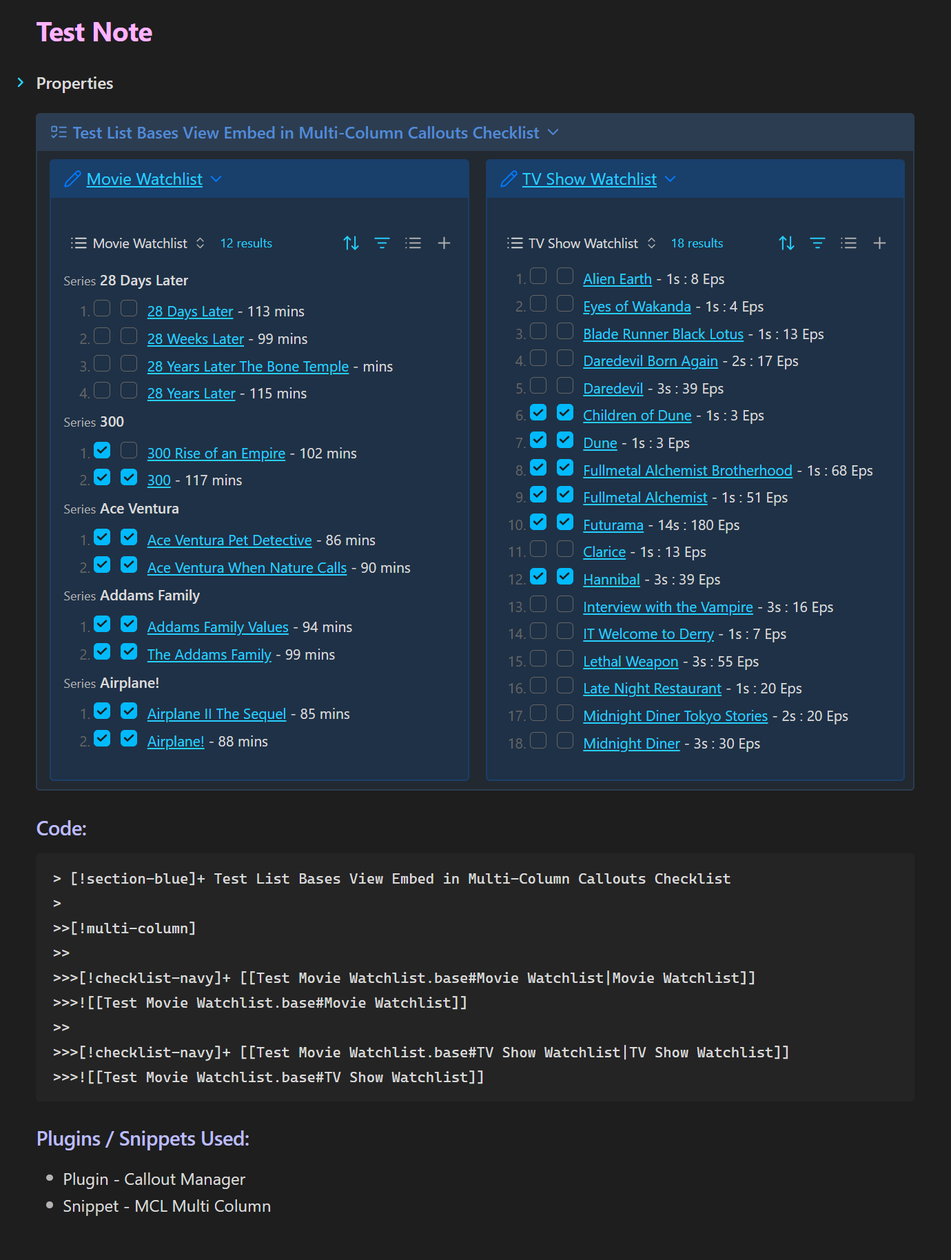

The list view in the 1.10 update regarding bases function is beautiful and it really shows how clean a generated list from bases could look like, but it would be so much more usable if its directly editable when viewing, especially with checkmarks and possibly something like number/text input.
Here is an example of a test checkmark based embedded bases list view:
Currently in list view (and card view) the checkmark property is not clickable/changeable. The clickable link to each file also does not show any thumbnail/preview like the usual local links. Meanwhile in Table view it is massively useful because of the fact that it is interactive/editable.

Currently using the table view is the most usable view for tweaking data in a list/table format. Making the list property values non editable with a simple formula Property.toString makes it nicer and locked, but then editing things would require you to go into each note and edit the property instead of being able to edit straight in the bases view.
