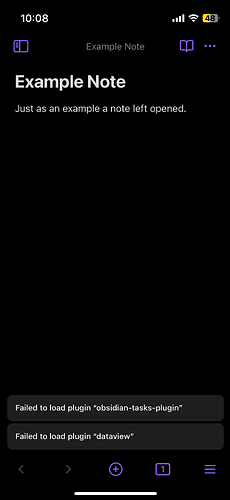

When opening an Obsidian Note on iOS via URI (e.g. as a Shortcut) whenever Obsidian hasn’t been opened before or have been closed for a long time (cold start), it does not load the note from the URI but the note that has been left open the last time obsidian was running.
In addition, the info-bars on the bottom appear twice and plugins (such as dataview or tasks) are displayed to be not loaded (though they work perfectly).

  • iOS18
  • Obsidian Version 1.8.10 (197)
  • PlugIns
    • Dataview
    • Calendar
    • Tasks
  • The problem is also reported on reddit (sharing links is not allowed in this forum)
  • I think it started after the improved loading of obsidian mobile
  • I attached a screenshot

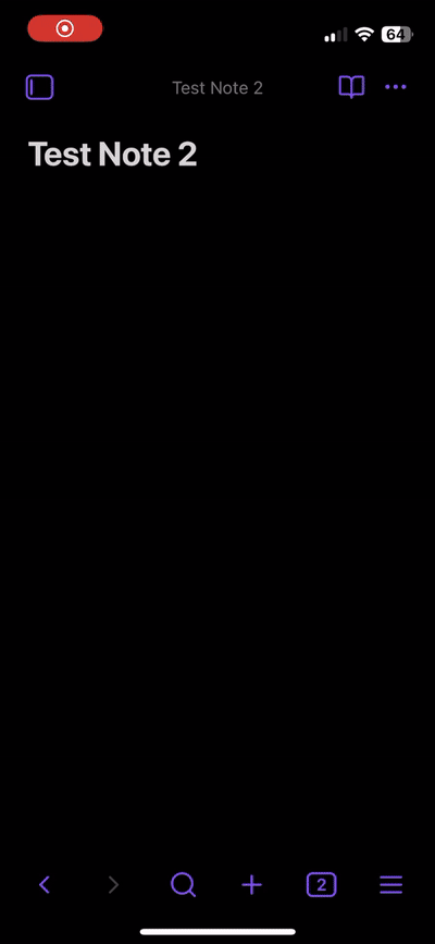

I created a test vault (in iCloud) with two test notes an repeated your steps, except I left Test Note 2 open. The link directs to the first test note. As you can see test note 2 still remains open.
IMG_0957

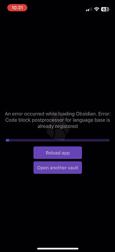

While rewatching the screen recording I noticed a message popping up, while opening up the iCloud-based vault. You can see it in the gif above as well.
The error message that is shown for a split second is saying:
An error occurred while loading Obsidian. Error:
Code block postprocessor for language base is already registered
Reload app
Open another vault
Here’s the screenshot:
I can replicate this in both iOS and iPadOS on Version 1.9.14, as mentioned by others:
  • It happens when you have both an Obsidian Sync and an iCloud‑based vault.
In my case, from cold launch: the error with the iCloud‑based Obsidian vault is triggered from a shortcut or a URI; when opening an Obsidian Sync vault, the issue does not appear.
To clarify, the error only occurs after the app loses its state. So if you open Obsidian, switch vaults, go to the home screen, then open the iCloud vault URI, it will open correctly.

I do also get the same error when cold starting the app: ”An error occurred while loading Obsidian. Error: Code block postprocessor for language base is already registered”.
I’m on iOS 26.0.1, using Obsidian 1.9.14, and my vault stored in iCloud.

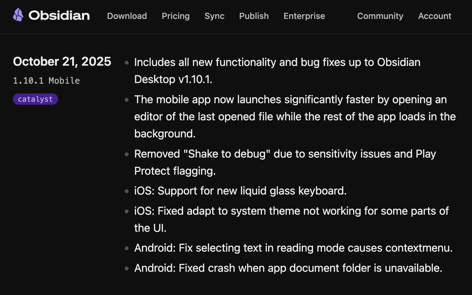

My hope is that 1.10.1 significantly changes the startup behavior (in a good way).
On reddit, @kepano already replied to worries of users that like to start the app with their own homepage. So I see progress with notes called via URIs as well here.

It does change the startup behavior, but I am not sure it’s going to fix your problem
