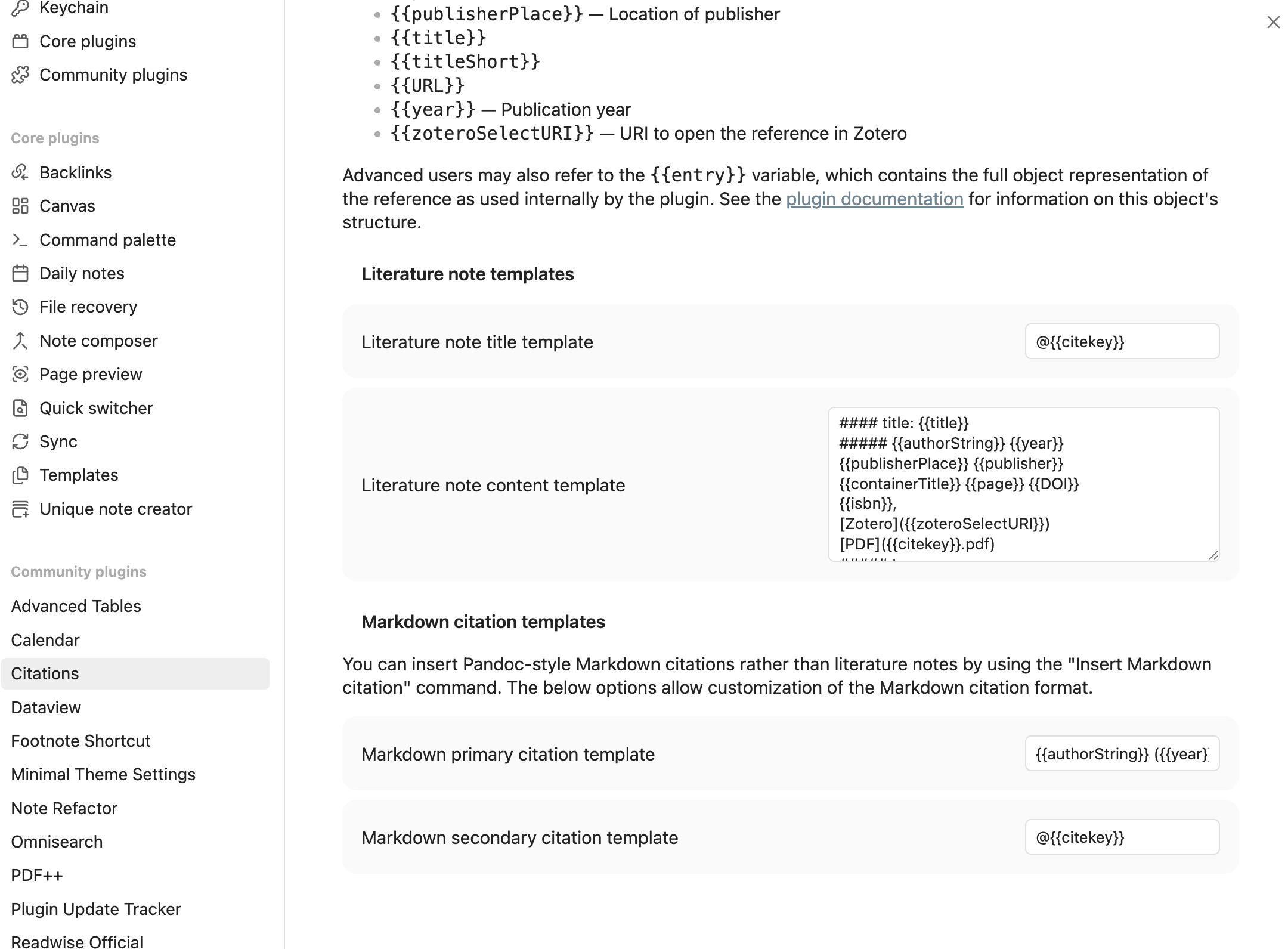

I use a PlugIn in Obsidian called Citations. I realize perhaps this is part of the break.
This may be the issue:
Literature note title template @{{citekey}}
I am going to add a photograph.

Wow! Thank you. This worked.
