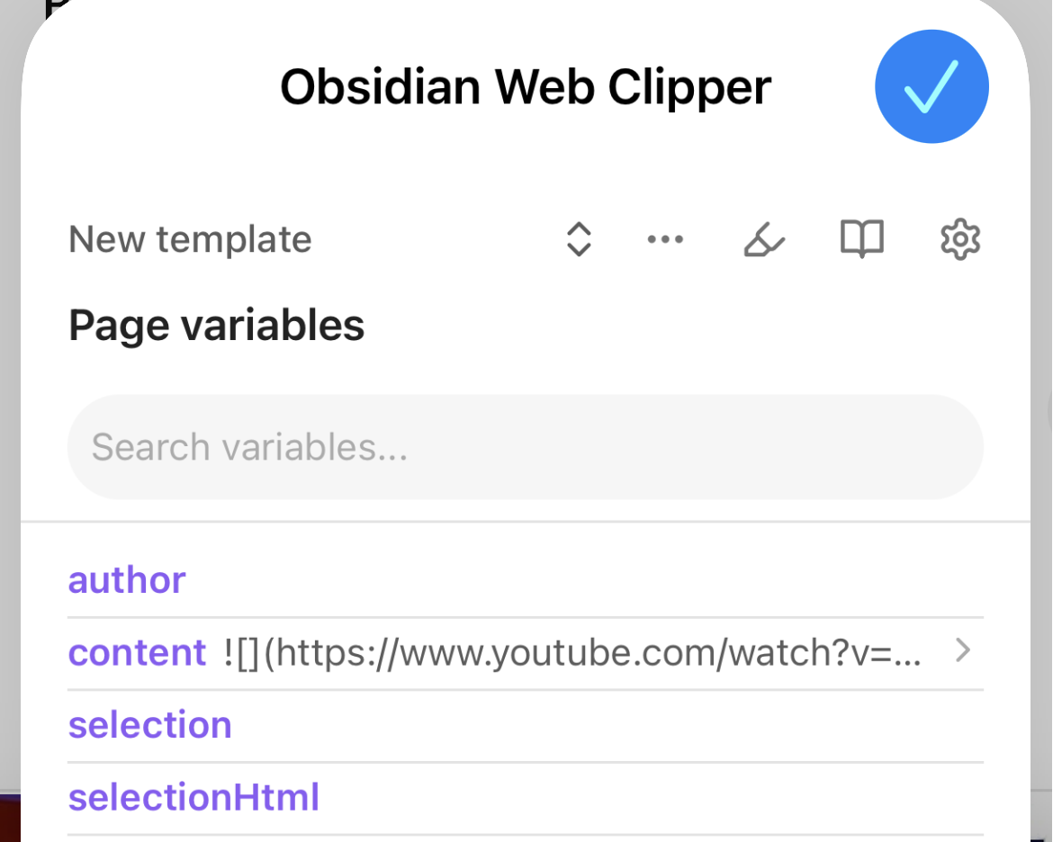

However, a mobile version of the website might not resemble the desktop version. I tested it quickly on iOS and you can see in the image that the author field is empty. For the same video on desktop it correctly showed the YouTube channel.
So you can check if the same applies for you and then you need to adjust the template for mobile to reference a different variable than author.

I tested some more websites and it seems (I dont know why) that on mobile sometimes the author field is not filled, but it will be filled when you simply reload the website. This also worked on YouTube.
