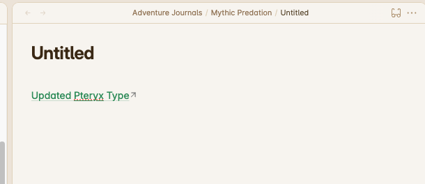

It appears that all other types of links work in both Live Preview and Reading modes, except for [link](obsidian://open?vault=….) links. The obsidian links only work in live preview, but when I enter Read mode, it just shows the link as plain text (as it would appear in Source mode).
I’ve made sure there is an empty line above and below the link, and that it’s the only part of the line (not embedded in with other text), so as to eliminate any possible interference with adjacent formatting. I also put the same link into an otherwise empty document (no YAML block or anything else), and the same behavior exhibits itself.
I also tried going back to the default theme, without any change to the behavior.
I’m working on an M1 Mac and syncing to an iPhone, which has the same issue with that sort of link. OS version 15.3, Obsidian version 1.8.4., Theme: Primary
Source Mode:
Live Preview:
Reading Mode:
