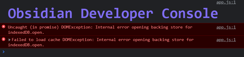

Developer’s Console
For what it’s worth, I’ve never seen the error below reported in the console. It mentions the term “indexed”, which makes me think it is related.
Uninstalling v1.2.8 and reinstalling v1.1.16 resolved the issue for me. I’m no longer seeing the above error in the developer console and the indexing does not occur on each vault open.
I’m cool with v1.1.16 for now, but the error seemed to interfere with the use of Dataview.
Okay, maybe it was reinstalling Obsidian that corrected the issue. I used the v1.1.16 installer and see now that I’m on v1.2.8.
The indexing issue has not come back up yet.
