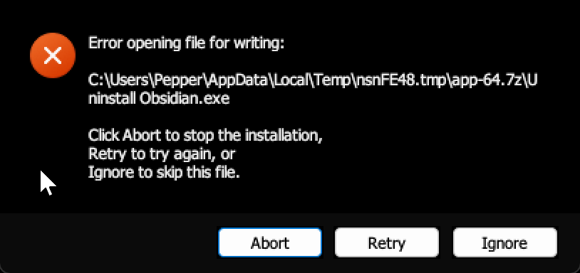

Attempt to install
Get the abort retry ignore error
-Abort cancels the install, so it’s not installed.
-Retry will bring this error message back up.
-Ignore will close the installer, and Obsidian is not installed.

A picture of the error message:
(the .tmp directory is different every attempt, but beyond that it’s the exact same error every time)

No idea. It works fine for me. We’ll keep this open and see if we gather more reports.
Maybe an antivirus thigs? I don’t know.
I believe I’ve resolved the problem. Turns out the problem was Windows AppLocker. Specifically, it was blocking whatever Obsidian was trying to run from the temp directory during the install process.
I disabled AppLocker long enough to install Obsidian and it worked.
If someone has a similar issue, they may have the same problem. Or they can try the things I tried before (I got all of those things from previous threads that worked for others).
