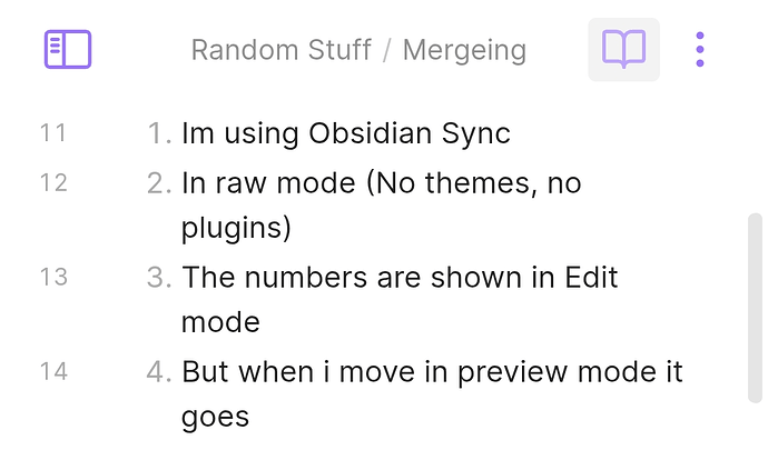

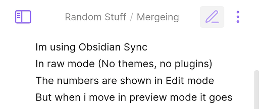

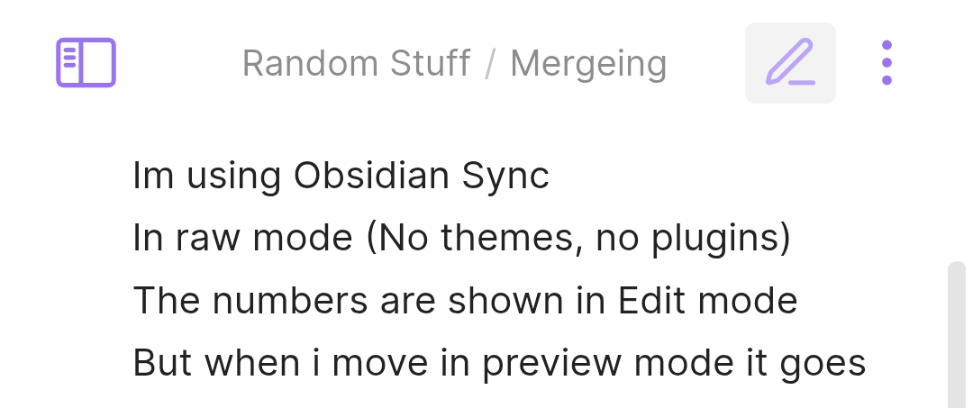

I’m experiencing an issue where numbered lists (e.g., 1. One, 2. Two) appear correctly in the edit view but are missing the numbers in preview mode. Only the text content shows—no numbering or list formatting is preserved.
  1. Open obsidian and edit a Note
  2. Add numbers like (1., 2.) Etc..
  3. The numbers are shown in the Edit mode, but when i go in preview mode the numbers are gone.
Did you follow the troubleshooting guide? [Y/N] Y
In the preview mode the numbers are shown as bullets shows.
Only the text shows, the numbers are disappear.

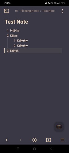

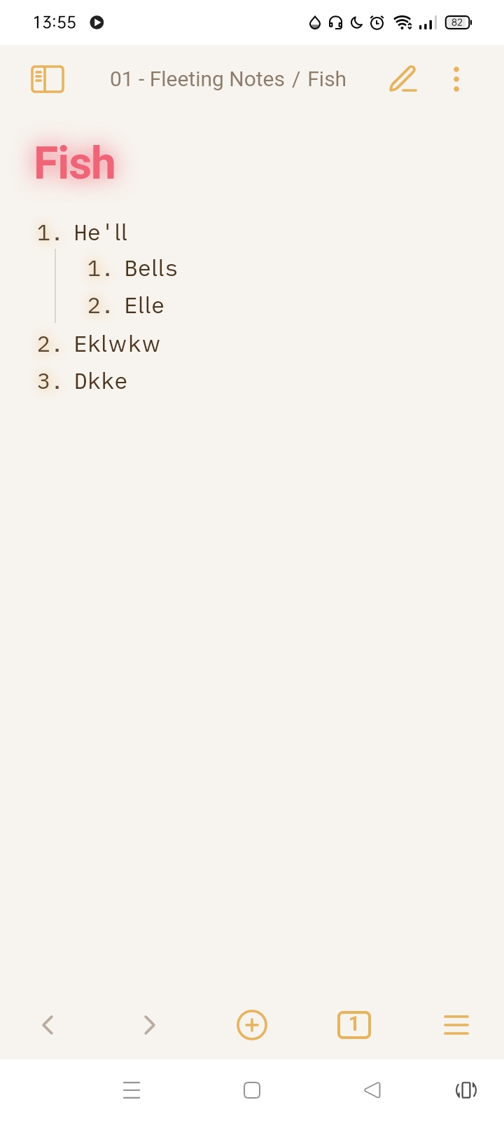

And it appears that the Android System WebView is at fault for this, as I have found out—I found a temporary fix—by uninstalling it’s updates to which the numbered lists started to reappear again in preview mode.
before uninstalling Android system webview:

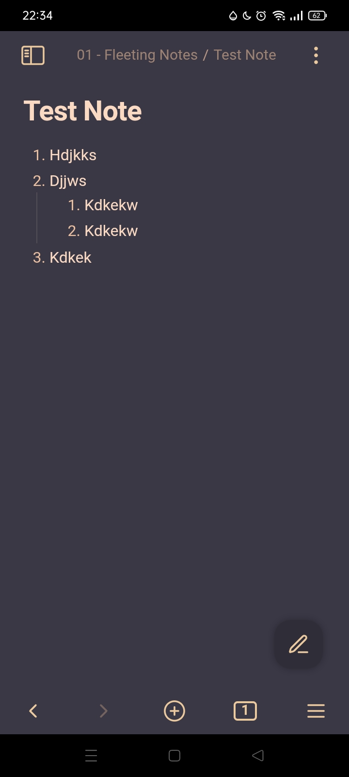

After uninstalling Android system webview:

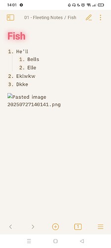

However, there are downsides that I have found (two as of now) when I did this. First of all, after you uninstalled Android System WebView, Obsidian returns to its “Welcome” start-up after you first installed it (vault data is not affected though):

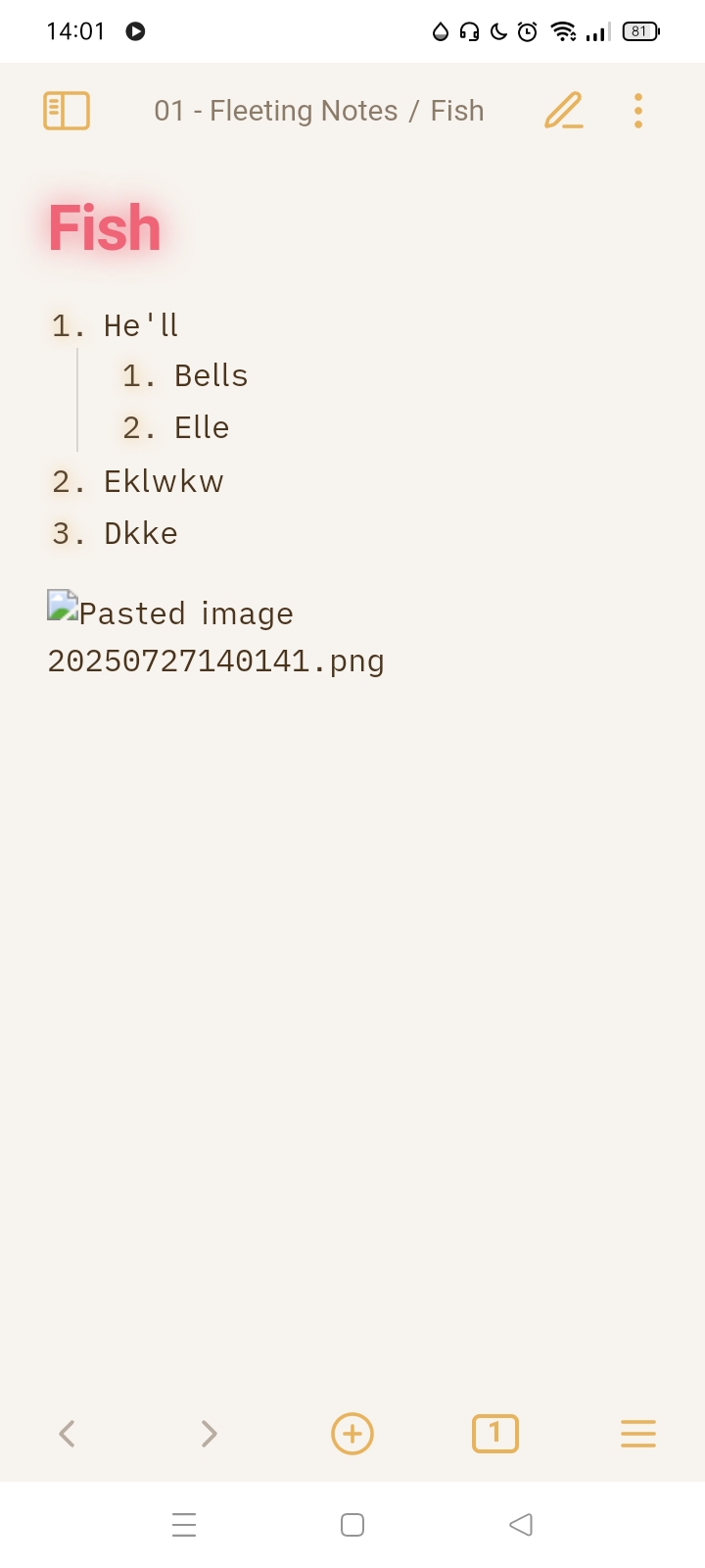

Second, when pasting images, it instead displays a broken image thingy, as seen below:
The other images that are pasted—before uninstalling the webview—are fine. It’s just the new pasted images have the problem.

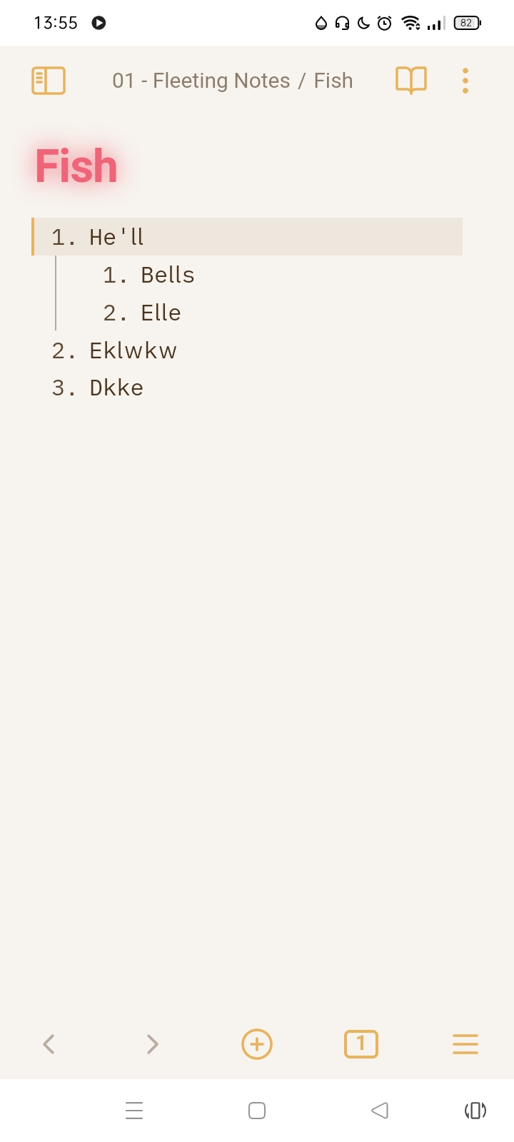

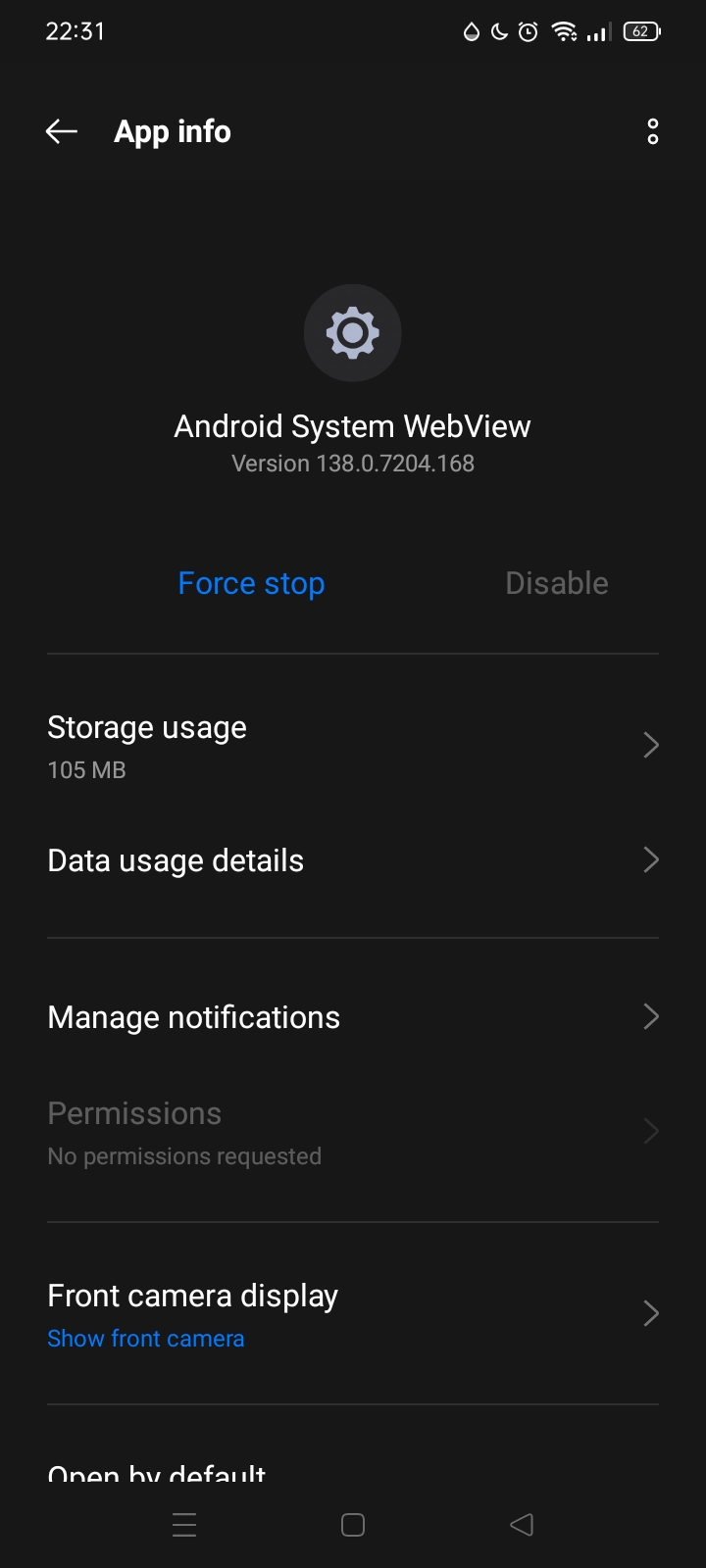

As for my side, it’s all functioning well now :smiling_face_with_three_hearts:. WebView beta is indeed the culprit!

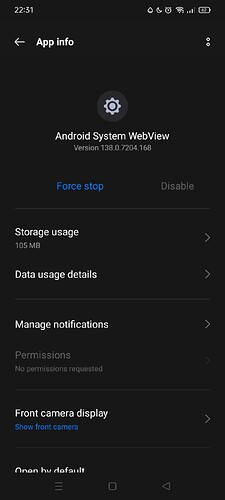

WebView stable:
Numbered list is now working again in preview mode:
The problem is gone :smiling_face_with_three_hearts:, thank you :folded_hands:.
