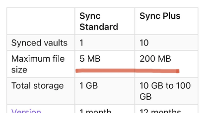

The note freezing the app sounds strange, but just to get it out of the way: you mentioned 1GB of space, so you are using the Sync Standard plan. Are any of the images over 5MB in size? If so, they won’t sync.
Once you check the image sizes, I would create a new note with the same text and say half the amount of images to see how it goes.
Thanks for pointing out the image file size in the basic plan; good to know.
I do not have any files larger than 5MB. The issue seems to be image files pasted as objects (somehow) and not linked in the notes. I deleted all those images, and can view the note now on iOS.
