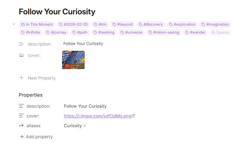

I’ve created and published a test vault, and I’m trying to figure out how to set-up my properties to display each page’s cover image when sharing the page link on social media.
However, I’ve run into 3 questions when editing my properties, which I will reference in the attached screenshot and URL below.
(1) When I created my properties immediately underneath my tags, why did a 2nd set of properties appear immediately below ~ and is there a way to eliminate this redundancy?
(2) When I added an alias in the 2nd set of properties, why was this property not duplicated in the first set of properties?
(3) What I do I need to change in my property settings to get the image on THIS PAGE to display as a cover image when sharing the link to this page socially?
Thanks in advance.
The second set of properties is Obsidian’s native properties list. You appear to be using a plugin that generates the top tags and properties list, and for some reason Obsidian doesn’t like how the plugin implements it, so it duplicates your properties in a proper, vanilla Obsidian way.
Without knowing the specific plugin you are using, the only thing I can recommend is going to Settings → Editor → Properties in document and setting it to Hidden. This will hide the second list, but could also affect your first one. If you try it and both sets get disabled, we can help you create a CSS snippet to exclusively target the bottom list, it’s just more work.
The answer to your second question is the same — you are using a plugin for your first set of properties, so it must be an issue or intended behavior within the plugin. If you are keen on using it, I would recommend you only add properties to the top list, not the second one.

The plugin to which you are referring was Make.md, which I installed so I could reorder the folders and files in my desktop app to match my Publish display. Turning it off did, as you suggested, delete the duplicate list of properties, so thanks for that. I can certainly manage without the plugin.

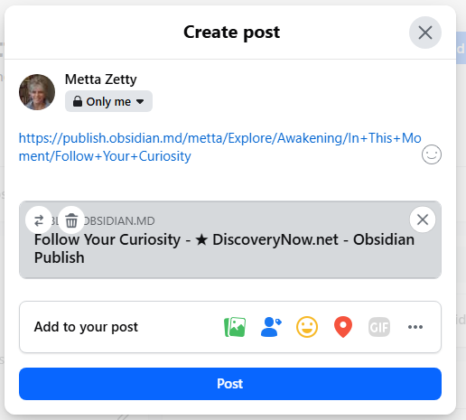

However, deactivating the plugin did not solve my 3rd question about the display of my cover image when sharing on social media. FWIW, I have tried using both versions of my imgur link, and neither displays the photo as a proper cover image when I try to share THIS PAGE on Facebook:

I would expect your second link to work.
Your screenshot shows colons in your property names. The Publish property is cover without a colon. Same for description.
It would look like this in Live Preview and Reading modes:
and like this in source mode:
description: Follow Your Curiosity
cover: https://i.imgur.com/ydfOdMo.png
Just to be thorough, I’ll mention that it’s also okay to have quotation marks around the URL:
cover: "https://i.imgur.com/ydfOdMo.png"
Thank you very much, @dawni, for taking time to follow-up. I genuinely appreciate your offer to help out.
FWIW, I duplicated your recommended properties set-up, and deleted the colons, but I still didn’t get the desired image display. See attached screenshot.
Do you (or does anyone else) have any idea what might be causing this display issue?
