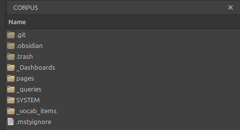

This is one of my vault’s contents on Linux Mint:
I have more vaults (these are the top level folders, with the vault names used by Obsidian, based on the folder name):
Given the same situation, I would need to copy CORPUS, Dusk, etc. folders to a drive and copy to the new PC, then I would need to install Obsidian and OPEN the folder as vault:
As you can see, I didn’t open many of my vault folders on Obsidian Linux yet…
Obsidian will index your files and then you can continue where you left off on the other PC. Basically you carried out a manual sync.
