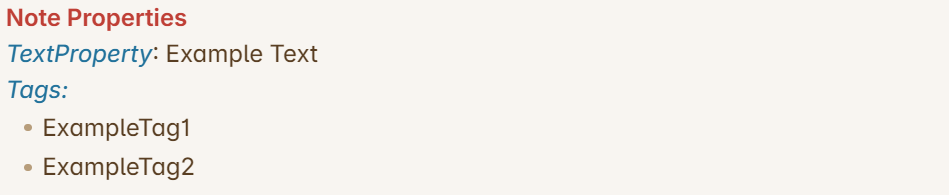

I would like to make a button which when pressed, reads the properties of the note it is in and prints the properties as plain text in the body of the note.

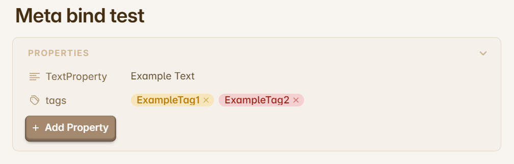

For example, if I have a note with these properties:
I would like my button to print something like this:

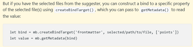

I found a Reddit comment which sounds like it would let me do what I want.

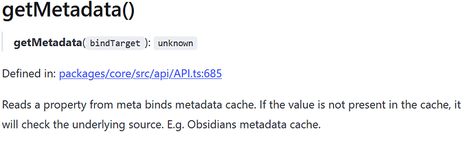

It suggests using the GetMetadata fuction of the metabind to be able to read the actual value of the metadata. Here is the excerpt from the documentation:
However, even after I obtain this value I am not sure how to make a button actually print it in the note body. I admit I am a beginner when it comes to coding in Obsidian, so there is probably something obvious I’m missing!

try this note out:
TextProperty: Example Text
tags:
  - ExampleTag1
  - ExampleTag2
```meta-bind-button
label: stamp properties into note
icon: file-down
style: default
class: ""
cssStyle: ""
backgroundImage: ""
tooltip: "stamp properties into note"
hidden: false
actions:
  - type: inlineJS
    code: let noteFile = this.app.workspace.getActiveFile(); let metadata = this.app.metadataCache.getFileCache(noteFile); let str = JSON.stringify(metadata.frontmatter)+"\n"; await app.vault.process(noteFile, (data) => { return data + str })
