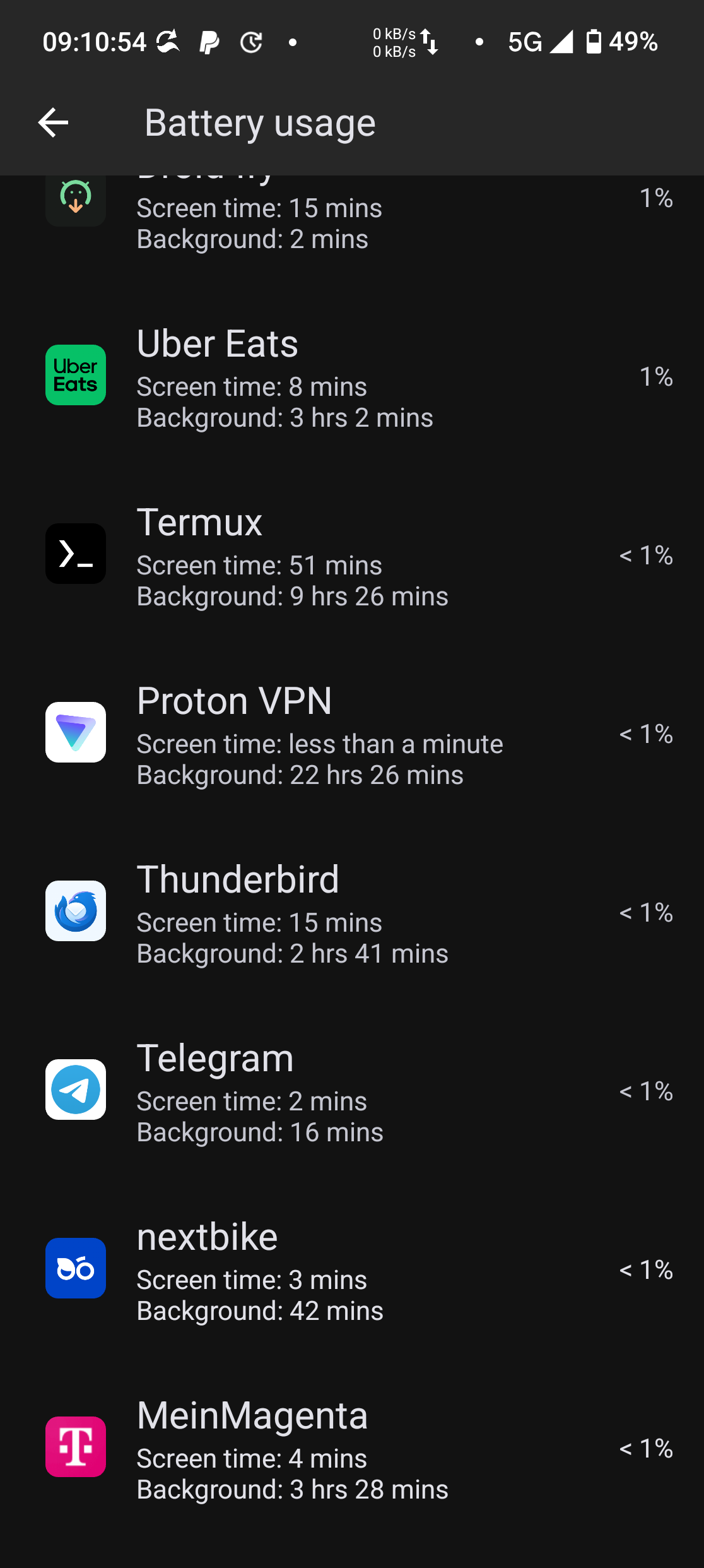

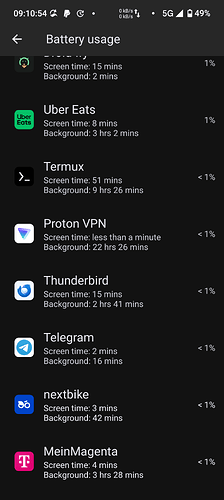

Hello Friends,
I was searching a solution for this problem too and think that I might found a solution using obsidian sync on android! I basically used Termux to use Fedora to use headless sync. Here is what I did (summarized by a LLM):
  1. Install Termux & Fedora-Proot
    • Install Termux from F-Droid or Play Store
    • Install proot-distro and set up Fedora:
      pkg install proot-distro
      proot-distro install fedora
      proot-distro login fedora
  2. Install Node.js & Obsidian CLI
    • Inside Fedora:
      curl -o- https://raw.githubusercontent.com/nvm-sh/nvm/v0.39.5/install.sh | bash
      source ~/.bashrc
      nvm install 22
      npm install -g obsidian-headless
    • or just run sudo dnf install nodejs
  3. Prepare a Vault on Shared Storage
    • Use Android internal storage accessible to Termux:
      termux-setup-storage
      mkdir -p ~/storage/shared/Obsidian/MyVault
    • Move or create your vault in this location
    • This makes it accessible to Termux, Fedora-Proot, and MTP for PC
  4. Map Shared Storage in Fedora-Proot
    • Create a symlink for easy access:
      mkdir -p ~/storage
      ln -s /data/data/com.termux/files/home/storage ~/storage
      cd ~/storage/shared/Obsidian/MyVault
  5. Start Headless Sync
    • Export your Obsidian Sync token (optional – you can also just login with ur username and passwort and 2fa key)
      export OBSIDIAN_AUTH_TOKEN="YOUR_TOKEN_HERE"
    • Run Headless in continuous mode:
      ob sync --continuous
  6. Optional: Automate on Boot (didn’t try this step yet)
    • Use Termux:Boot to run a script at device startup:
      mkdir -p ~/.termux/boot/
      cp ~/start-obsidian-sync.sh ~/.termux/boot/
    • Script example:
      #!/bin/bash
I did everything except step 6 but will try it out in the next days. You might want to try this too since it could be a handy solution and there is more experience needed to confirm this
And I forgot to mention: Exclude “?” from your filenames bc it will cause problems with sync
Here are the battery usage results after 9,5h of usage (less than 1% additional drain during that time).
