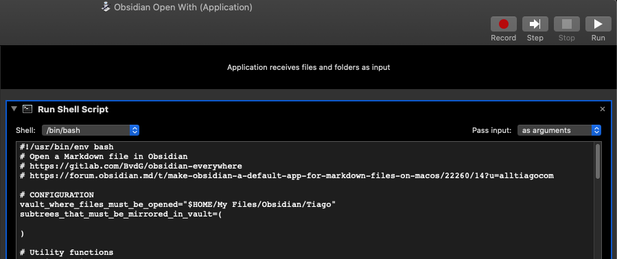

I just downloaded your script, created the app, but I’m still getting this type of error:
SCR-20241223-jxtv
SCR-20241223-kbjg
This is my vault:
/Users/dannywyatt/My Files/Obsidian/Tiago
I’m trying to open a file:
/Users/dannywyatt/My Files/Obsidian/Tiago/Wavebix/About Wavebix.md
Here’s my Automator, which seems to follow your instructions:
Finder is clearly seeing it as an application:
Am I missing a step or something else?
Thank you!
