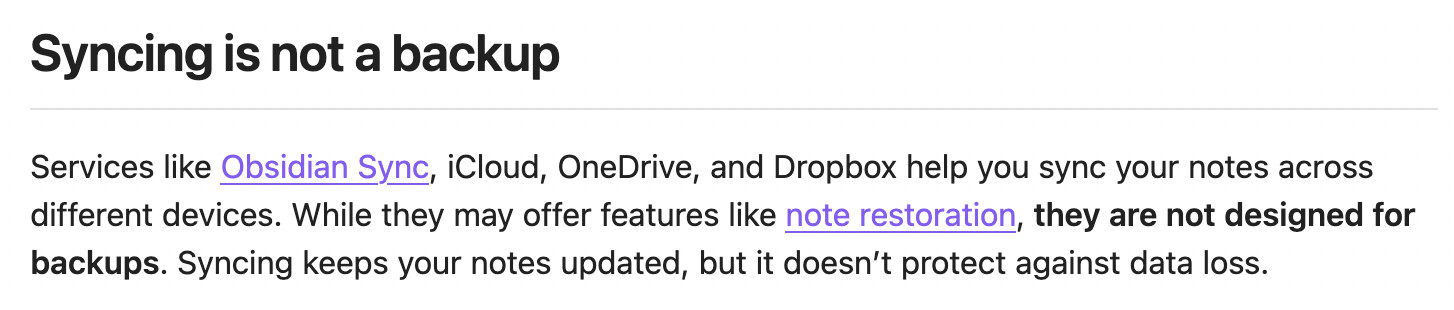

  • It is not a good idea to use a syncing tool as your only source of backup. Sync tools are not intended for backups. The only reason they are better than nothing is because they have a window of history, but those windows can be short. But when you mix multiple sync tools, they can be worse than nothing because they fight each other.
