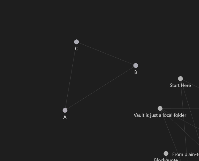

Local graph does not show relationships between nearby notes
  1. Open a sandbox vault and create three notes (e.g. A, B, and C).
  2. Link all the notes together such that they form a triangle in the global graph view, as in the screenshot below.
  3. Navigate to any of the three notes and open the local graph view. (It doesn’t matter what depth setting you set the graph to: this happens regardless.)
Yes! Steps given above were performed in the sandbox vault.
All the links between the notes should be reflected in the local graph view, just as they are in the global.
In the local graph, notes A and C are not connected despite them being linked to each other.

Here is an example from my vault, where adjacent days’ journal entries do not appear to be linked together when viewed from the weekly note’s local graph.
Every day is linked to the days before and after it, and the week has a link to every day in that week. However, the local view does not reflect these links between adjacent days, despite them appearing correctly in the global graph view.
