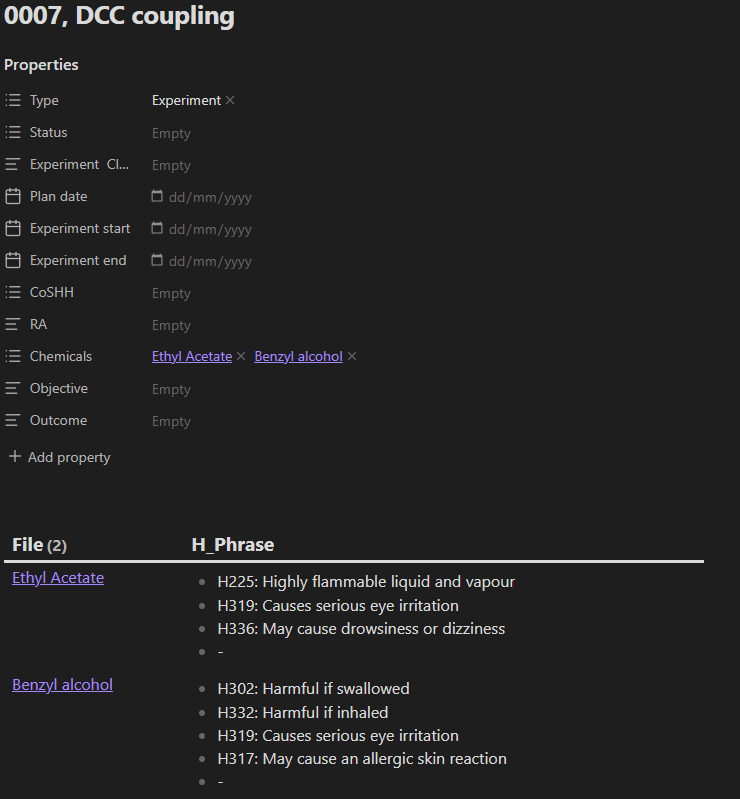

I am trying to use Obsidian as an electronic notebook for chemistry experiments. Here is the proposed workflow:
I have a series of files, one for each chemical, in a folder called “Chemical Database”. In the frontmatter of these files is a list property called “H Phrases”, where the hazard phrases of the chemical are listed.
For each experiment I would create a new note in a folder called “Lab Book”. In the frontmatter of each experiment, I would have a list property called “Chemicals”, in which the chemicals used in that experiment are linked.
What I would like to happen is for the “H Phrases” from the chemical file to be pulled into a dataview table within the experiment.
I currently have the following working:

To reference links in the current note, you would do:
FROM "Chemical database" and outgoing([[#]])
However, your method looks through all links in the experiment and returns all linked chemicals, including a chemical you link to while taking notes or link to in a different property. For a more efficient query and to free up the rest of your content to link at will, go with:
```dataview
TABLE H_Phrase
WHERE contains(this.Chemicals, file.link)
The query doesn’t add null values on its own. Open your chemical note, view it in source mode, and check whether you have any extra lines or nonstandard syntax in the H_Phrase value. For example, the second item in this list is null and would be represented by a dash in the table:
H_Phrase:
  - "H319: Causes serious eye irritation"

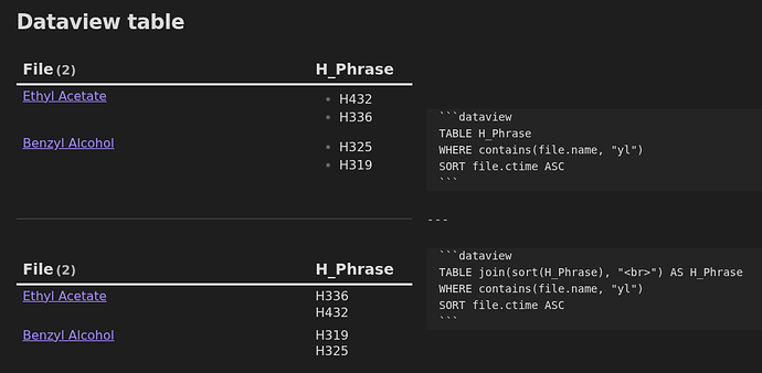

Remove bullet points + ascending order
You just need to edit @dawni code slightly. This will make the bullets disappear, sort your table in alphabetical order and your H_Phrase entries in ascending order.
```dataview
TABLE join(sort(H_Phrase), "<br>") AS H_Phrase
SORT file.name ASC
