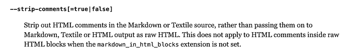

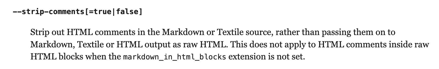

Pandoc has --strip-comments[=true|false] which applies to html comments.
https://pandoc.org/MANUAL.html#pandocs-markdown
