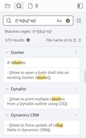

In this case, you want to search for “lu” but not “blue”. We can do this by entering the following regular expression (including the slashes) into the Obsidian search bar:
/[^b]lu[^e]/
Here’s what it means:
  • /: begin the regular expression.
  • [^b]: Match any single letter except b.
  • lu: Match the letters “lu”.
  • [^e]: Match any single letter except e.
  • /: end the regular expression.
In my vault, this finds “Volumes”, “columns”, and “rollup”, but not “blue”.

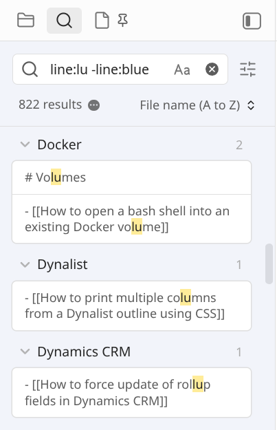

The line option tells Obsidian to restrict its searches to individual lines in your vault, rather than entire pages. So a similar search to your original query would be:
line:lu -line:blue
This means:
  • line:lu: Find all lines containing the letters “lu”.
  • -line:blue: But filter out lines containing the letters “blue”.
In my vault, this gives me a similar result as our regular expression:

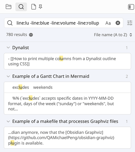

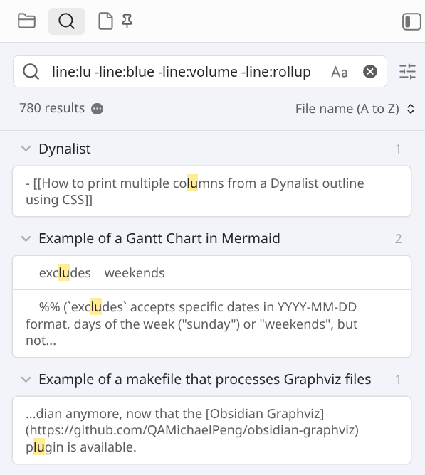

And it’s easy to exclude “volume” and “rollup”:
line:lu -line:blue -line:volume -line:rollup
I recommend trying the line option out to see if it meets your needs.
