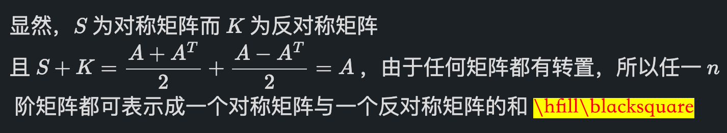

But I want it at the same row my proof ends, so I tried $\hfill\blacksquare$ , but it failed to render.
However it’s highlighted like this
And this usually appares when there is invalid grammer, so I wonder if I can do that by using \hfill, if so how; and if not, what should I do to add the tombstone to the end of the line without using multi-line math?

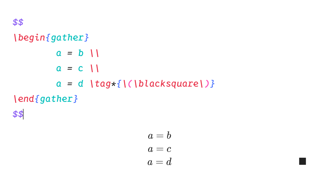

see here for \hfill. it only works in certain environments because otherwise MathJax doesn’t know how much space to fill.
for getting \tag*{\(\blacksquare\)} to show up in the correct position, try using a gather environment, like so:
