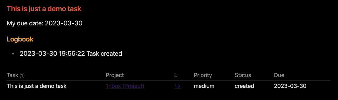

# This is just a demo task
My due date: `= date(this.task_due)`

Reading View:

I added that query to my local copy of that task (and slightly modified related to the FROM clause), and when in reading view I get this:
In other words, everything works as expected.
