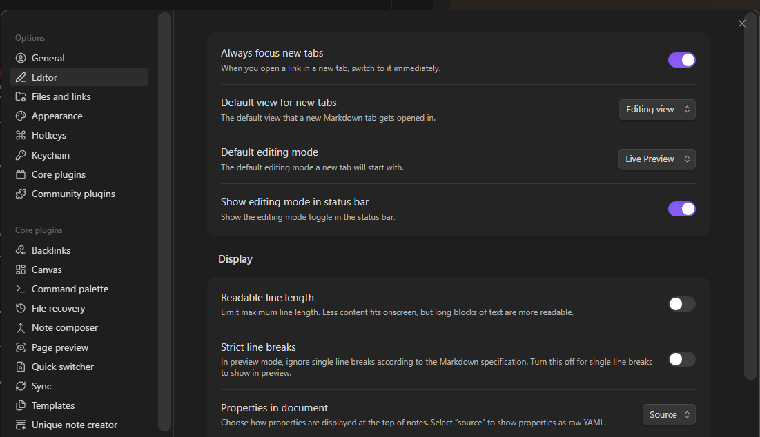

It may be that you already have frontmatter on the note and aren’t viewing it.
In that case, change your ā€œproperties in documentā€ mode to ā€œsourceā€ to see it properly and have the ability to edit it directly.

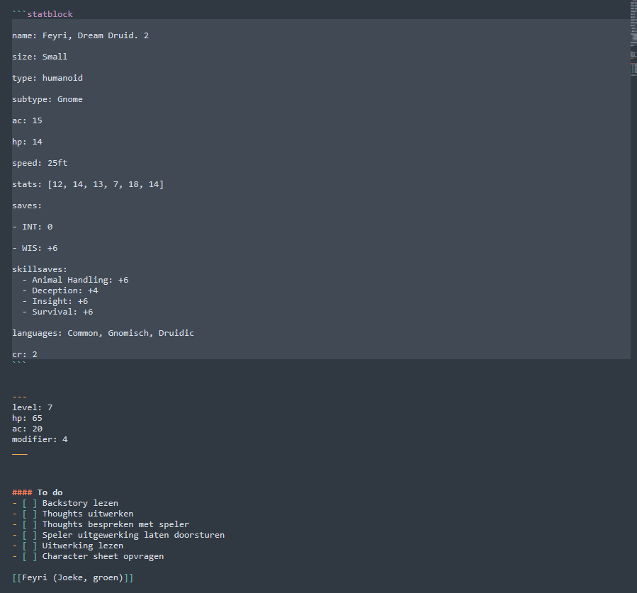

Yes off course, thank you for your help! I managed to create a player statblock but not the table for the initiative tracker.
Feyri (Joeke, groen).md (584 Bytes)

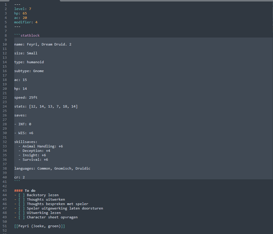

OK I opened this in sublimetext and have spotted a couple of issues:
you need your yaml to be the first thing in the file, bar none. Additionally, I think your --- that ends the yaml might have been converted into a different kind of line.
it should look like this:
