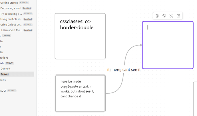

I cant see css in canvas cards
Hello. I cant write or even see css in canvas cards. Even in canvas-candy tutorial, they are empty for me. When i write — it turns to the line and then everything else turns into Title.
ive tried \ and space and everything inside card. Turned on and off. New vault also. I see how it works in internet, why it looks so different?

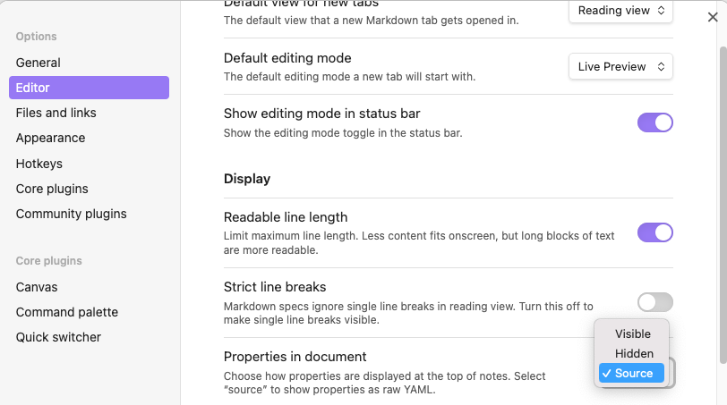

I cloned the repo and observed the following problems:
  • Frontmatter is not visible in the cards when you click on them, because the setting “Editor → Properties in document” is set to “Hidden”. It should be “Source”
  • This repo uses a syntax for cssclasses that is not compatible with current Obsdian versions. A comma separated sequence of classes no longer works. It has to be translated into a proper yaml list. At some points it uses cssclass instead of cssclasses which has been deprecated.
I created a fork of the original repo and fixed these problems. I also removed the blur applied to the drop-shadow effect, because it is not required and had the side effect of blurring a bit the content too.

I just started playin around with Canvas Candy. The downloaded vault functions as it should, but then after copying over the canvas candy css snippet to my own vault it just would not work. My “Editor → Properties in document” were set to visible. Changing these to Sourc in Editor settings solved this problem.
