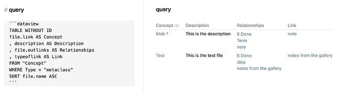

Hello.
This works in a local test vault:
```dataview
TABLE WITHOUT ID
file.link AS Concept
, description AS Description
, file.outlinks AS Relationships
, typeoflink AS Link
FROM "Concept"
WHERE Type = "metaclass"
SORT file.name ASC

Or are you asking about something entirely different?
On a possible related side note, if typeoflink is set to [[metaclass]] you can’t do typeoflink == metaclass, but needs to to typeoflink == link("metaclass") or typeoflink == [[metaclass]] in your DQL query.
And you also need to change the syntax/mapping if you want to showcase each of the outlinks with their associated link type.
