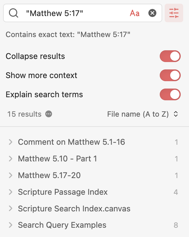

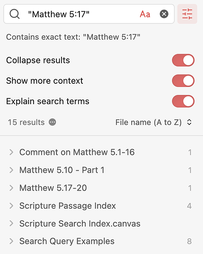

There are two ways you can do this with the built in Search plug-in.
1) Literal Search
Just simply type the passage you are looking, e.g., Mt. 14:22-33. Note, because of the colon, you will need to put your search query in quotes, “Mt. 14:22-33”

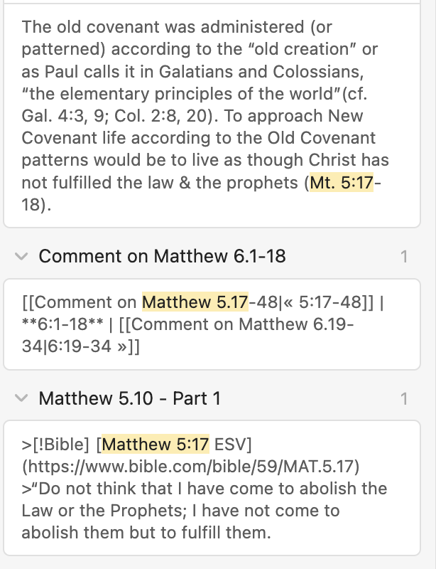

This will bring up everywhere that the exact text “Mt. 14:22-33” is listed. Here’s an example from my library using Matthew 5:17:
The problem with this route is it only finds results that exactly match the search query, so it wouldn’t surface “Mt. 5:17” or “Matt 5:17” etc.. You would need to manually type in the various formats of how that passage might appear in your vault to get all the different results.
