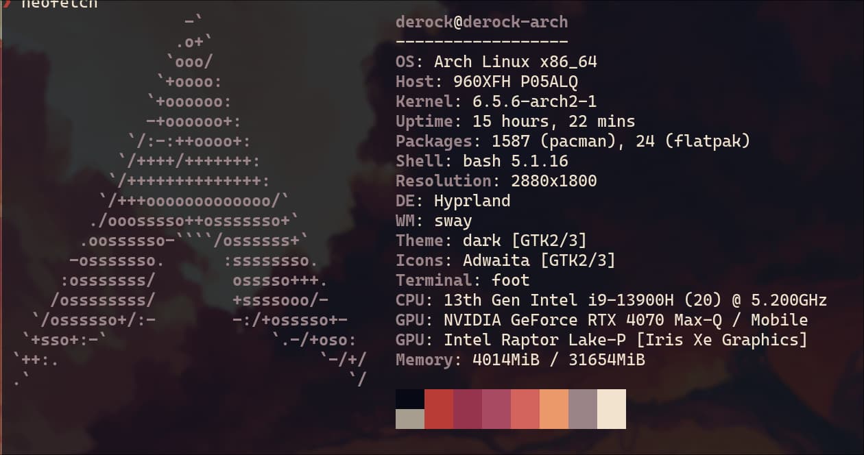

My System
(I want to use the Intel Raptor Lake-P [Iris Xe Graphics])
