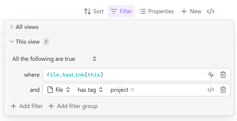

Bases can look at links in your note body, along with some other info that isn’t in the properties, such as paths, embeds, file size, creation date, inline tags… Here’s the list.
At any rate, you needn’t change your current set-up. These two Bases filters create the equivalent of your Dataview query.
FROM [[]] translates to:
file.hasLink(this)
FROM #project translates to:
file.hasTag("project")
You can add them to your base filters like this:
