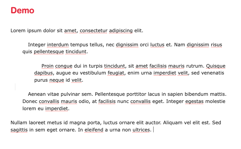

I wrote a css snippet that tries to remove all this, and leave only the indentation. This is the snippet:
Description: Turns blockquotes (>) into simple indented paragraphs.
/* == 1. Live Preview / Editing Mode == */
div.cm-line.HyperMD-quote .cm-blockquote-border {
    display: none !important;
div.cm-line.HyperMD-quote::before {
    content: none !important;
    border: none !important;
    background: none !important;
div.cm-line.HyperMD-quote {
    text-indent: 0 !important;
    box-shadow: none !important;
    padding-inline-start: 0 !important;
/* -- STEP 3: Apply our custom indentation per level -- */
div.cm-line.HyperMD-quote-1 {
    padding-inline-start: 2.5em !important;
div.cm-line.HyperMD-quote-2 {
    padding-inline-start: 5em !important;
div.cm-line.HyperMD-quote-3 {
    padding-inline-start: 7.5em !important;
/* == 2. Reading Mode == */
.markdown-reading-view blockquote {
    border-left: none; /* Removes the vertical line */
    background-color: transparent; /* Removes any background color from the theme */
    margin-left: 0; /* Resets default margin */
    /* THIS IS THE LINE YOU CAN CHANGE for more/less indent */
    padding-left: 2em; /* Sets your desired indentation */
An example of markdown using it:
Lorem ipsum dolor sit amet, consectetur adipiscing elit.
> Integer interdum tempus tellus, nec dignissim orci luctus et. Nam dignissim risus quis pellentesque tincidunt.
> > Proin congue dui in turpis tincidunt, sit amet facilisis mauris rutrum. Quisque dapibus, augue eu vestibulum feugiat, enim urna imperdiet velit, sed venenatis purus neque id velit.
> Aenean vitae pulvinar sem. Pellentesque porttitor lacus in sapien bibendum mattis. Donec convallis mauris odio, at facilisis nunc convallis eget. Integer egestas molestie lorem eu imperdiet.
Nullam laoreet metus id magna porta, luctus ornare elit auctor. Aliquam vel elit est. Sed sagittis in sem eget ornare. In eleifend a urna non ultrices.
This how it looks in preview mode with the default theme:
Update. By adding this to the css snippet:
div.cm-line:not(.cm-active) .cm-formatting-quote {
you get rid of the extra space visible at the beginning of the first line in each quote (this is caused by the “>” that becomes invisible once the cursor leaves the paragraph).
