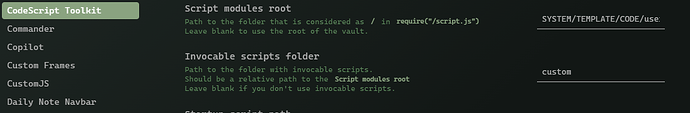

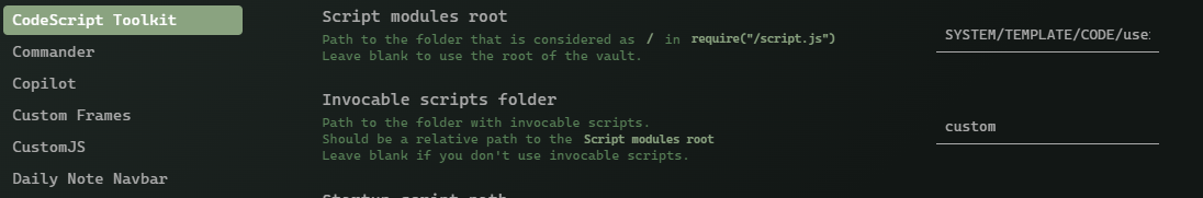

Save this as Go to First Line.ts in the folder where you will store your CodeScript ts (TypeScript) files.
You can bind a hotkey of your choice to this script:
